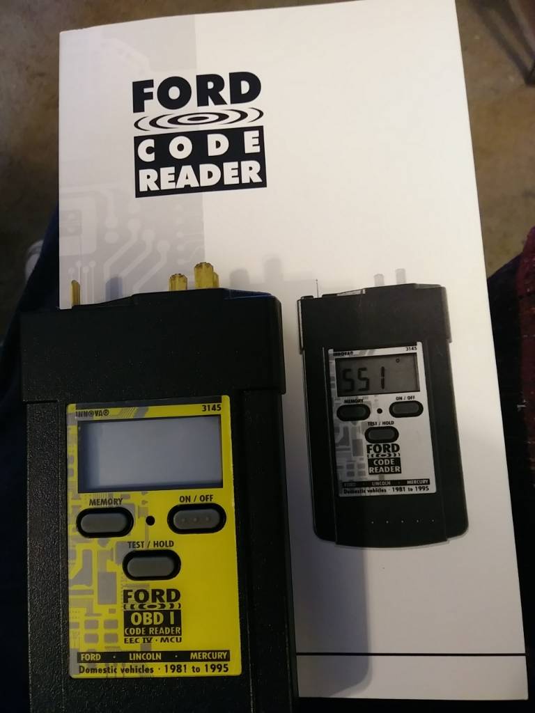

Well, I need to start learning to do my own code reading. I'll be picking up a cheap reader. for now.

Obd1 beginners class
The trick I have learned over the years is that the codes the computer does NOT use are as important as the one it did use.
Pretty much every system operated by the computer will have 4 to 15 codes the computer can pick from, why it chooses one over the others can help you narrow down what the problem might be.
So never google a code number, always look at the whole code list, to see any associated codes the computer did not use.
There are no "0's", zeros, in OBD1 codes, 2 or 3 digit, so not sure where 101 would come from?
There are no "0", zeros, in OBD1 codes, 2 or 3 digit, so not sure where 101 would come from?

But looking at ALL the codes is a basic step everyone should use for any OBD system diagnostics
