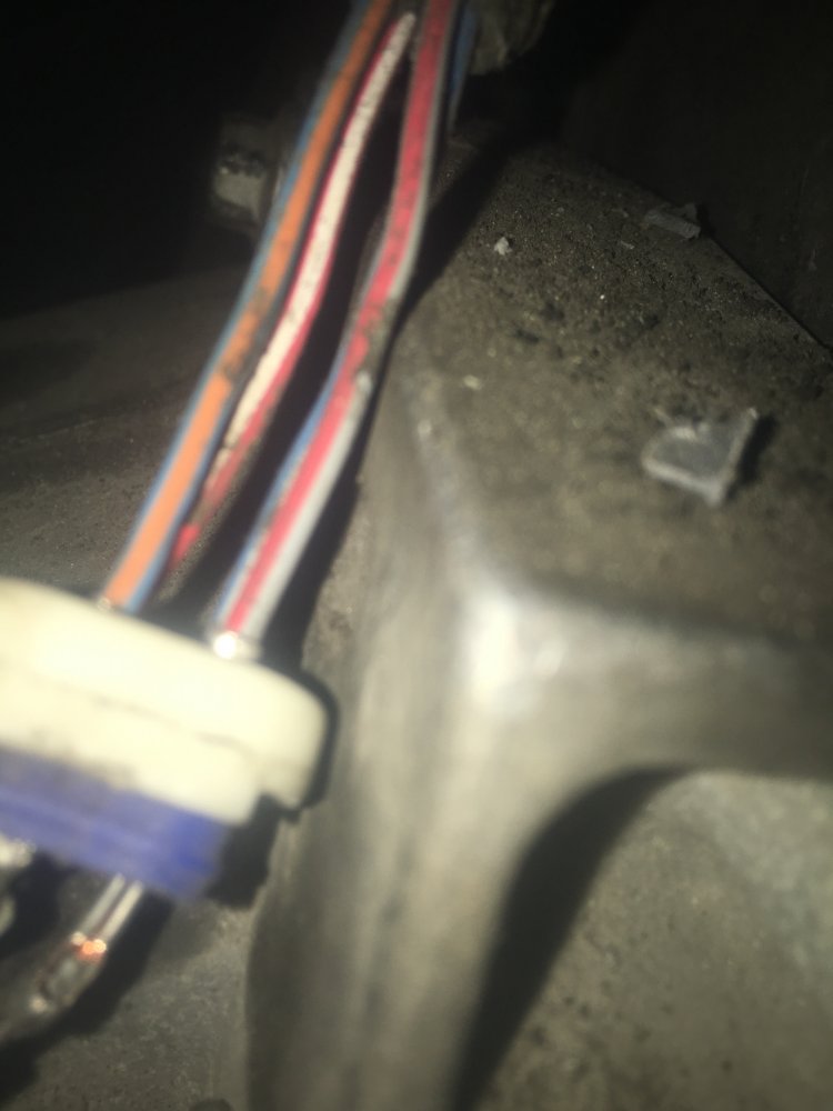

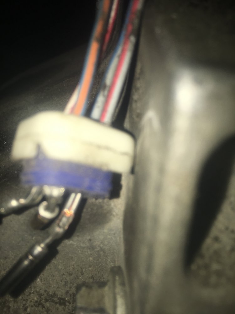

It is the upstream o2 on the passenger side. I took a couple pictures of it.
OK thats good
Sensor 1 1
wires we see are
Grey/red
Light blue/orange
White/red
Grey/light blue
That matches
grey/red and grey/light blue are the sensor wires
Light blue/orange and White/red are the heater wires
So you want to use the O2 sensors plug to match wires
Pin Diagram here: https://www.ford-trucks.com/forums/attachment.php?attachmentid=600&stc=1&d=1062542771
Grey/red is sig rtn
grey/light blue is HO2S sig
Light blue/orange is VPWR 12v key on
White/red is HO2S HTR ground for heater at computer
