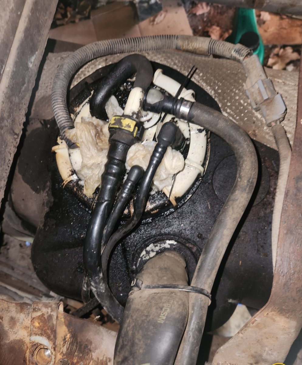

I have a 2002 Ford Ranger Edge 4WD extended cab 4 door 4.0L 5R55E transmission. Someone replaced the fuel pump and messed up the connectors on the fuel lines coming off the pump. I have not found what I need at the local salvage yards. Can anyone help me with the part numbers for the (Help, Dorman, etc) hose repair ends part numbers. Thank-you.
The middle line and the line to the right of that one. They are the lines that are running vertical in the photo. The middle of the 3 vertical lines is the one that is leaking fuel very badly. Thank-you.

Can you pull it off and inspect it carefully? It's going to be the line connection or the line itself, the fitting is cracked, or the o-ring is broken or missing. Also carefully inspect the male fitting that is part of the fuel pump sticking up. It may be cracked also.

Thank-you for the reply. The fitting does not appear to have an O ring in it. I have not been able to find the same type truck to compare to.
So the smaller lines are leaking?
That whole thing is weird to me. I'm used to only 2 lines (the bigger ones) there.
That's how those fittings work. The o-ring seals on the male part of the sending unit, and it's held on mechanically with the clip behind the ridge on the male part of the fitting.
Thank-you, I appreciate the help. The O-ring must have stayed on the old pump. The clips are missing. They had the two smaller lines held on with zip ties. I need to find where to purchase those clips, and the O-ring.

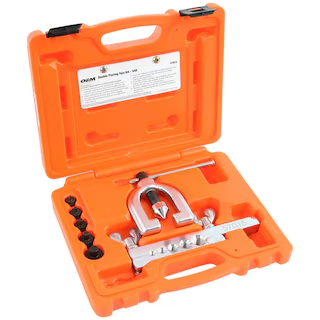

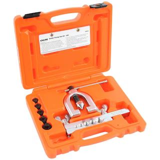

I've used this before. The bottom tool with the holes. match up the size, gently warm the end of the tubing, line up the connector, and push them together. I had someone push them together with a 2x4 while I had the fuel line and connector lined up.
