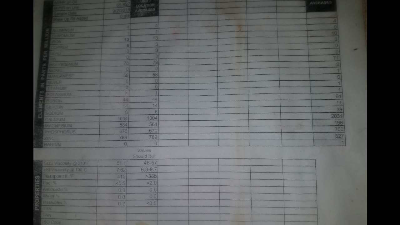

Yes, I used Blackstone. Went back and actually read how to read the reports, as this was my first analysis. There was a question mark by anti-freeze, so there was a question as to how bad it may be. I'm gonna have to start doing every other oil change now. And do 3K oil changes instead of 5K.
Lets see them results!
Heres my mine! I do my oil changes at 3k but my truck idles at least 15-20 hours a week. When i first sent my sample to blackstone they said my oil sample looked like that of a similar engine with a 5k oil change so they were concerned. I called them up and explained the idle time and they said factoring that in my engine is running well below average wear. When i switched from mobil 1 to pennzoil ultra my wear numbers went down even further.
These are my 3k numbers based on 3k averages.

28 bucks. Go to blackstone labs website they will send you a free sample kit. That 28 bucks can tell you if you have a bad head gasket, bad bearings, bad rings, the smallest issue. And they dont just send a form full of numbers, they give you a personal report explaining what they found.

That's pretty damn impressive.
