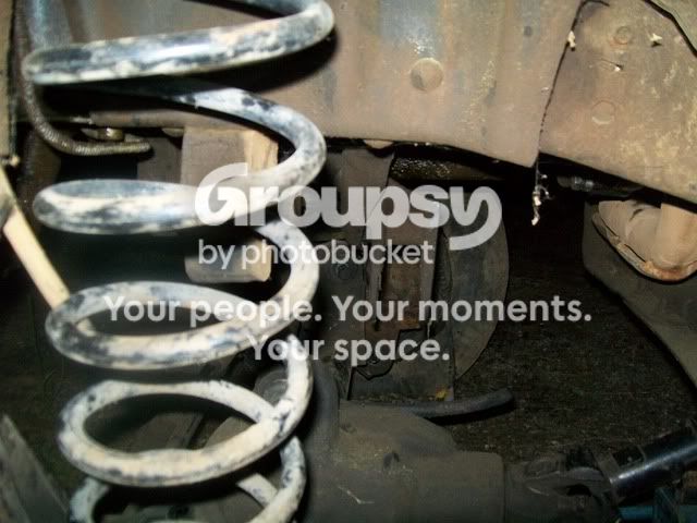

-rolled the d30 under just to check spring locations tires are only on there to roll it under so i didn't drag it (got knows i abused the jeep it came out of enough)
- Way high cause its on stands by the time i drop it a little bit and put the 33's back on it it should sit level again
- Links I'm going to be using they are from a Rubicon Express 8" xj long arm kit
wow lookin good i wish i had the money to do the d30 swap or at least get some 31's on my truck. i'll be watching this closely. btw how much did those long arms cost? and how close are the coils to lining up?
i bought those arms about 3 years ago :icon_rofl: they cost about 600 but if i bend one i can just by it instead of having to fab a new one. as for the coils they sit in the ranger buckets really nice just have to remove the tabs for the ranger spring and put a pipe down the middle to retain the jeep spring or if I'm lazy and have some extra money i know a spring shop that can make me some coils with the jeep twist at the bottom and the ranger one at the top, but you know how it goes.
oh and i forgot to mention that for now im going to be using a factory v6 xj coil hoping for it to sit level with the back for now then ill lift it when i get money for the right springs.
oh hope it works out. i was thinkin about using ranger springs and making a new lower mount. or some thing like that i like the ride that the ranger springs have
You cant use ranger springs they are way to stiff, about 460 pounds per inch where the xjs are about 280 ppi. You have to remember that the ttb has a 1.5 to 1 advantage over the spring which require the heavier spring rate. with the factory xj coil i am looking at about 2" or so of lift over stock.
