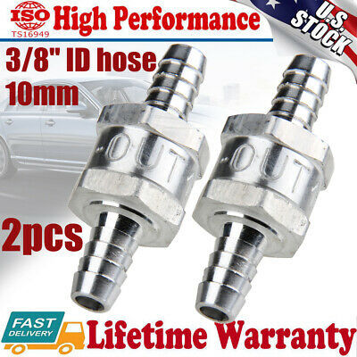

I haven't delved too deep into it but I would like to figure out some kind of standalone thing to vent the canister that doesn't require a computer.
One on cannister intake.
One on feed to intake tube.

R these made for these cannisters?I think relocating it to the passenger side right across from where it is now may work.just need to get rid of the oem battery tray.its a mirror image of driver side where it mounts now.
They're for whatever you want them to be.
