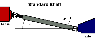

tom how do you get the pinion angle correct? do you just place the spring perch where it needs to be and bolt it to the springs then adjust? or do you have the tools to set the degree?
you place the perches on the axle then bolt the axle up loosely then you stick one of these angle finders (cheap and can find em all over)
http://shop.advanceautoparts.com/webapp/wcs/stores/servlet/product_x_25981706-P_x_x?cm_mmc=ACQ-_-Google-_-enhancedRM-_-25981706&ci_src=17588969&ci_sku=25981706&ci_gpa=pla&ci_kw={keyword}&gclid=CPnugr27kLQCFQuCQgodjEsA9g
on the housing part that is the same angle as the pinion. then you figure out what your output shaft on your t-case is at and try to get your pinion within 1-2* I believe. then tack the perches on and take it the u bolts off and burn the perches on. remember when welding on the axle to take your time and dont heat up the housing too much or you will warp it. if you have a lot of welding, take a lot of breaks and let it cool.
What Ben said basically. The only tool you need is an angle finder. And a flat spot on the housing that is parallel to the pinion.
Nor Cal chat thread
There are a few other methods too. If you are just swapping axles, not lifting, lowering, or changing the wheel base you can just pull the angle from the old axle.
If you're good, you can eyeball it. Most people can see a variance of a couple of degrees. But laying under a truck looking up at it can be difficult.
This is what you're trying to achieve.
