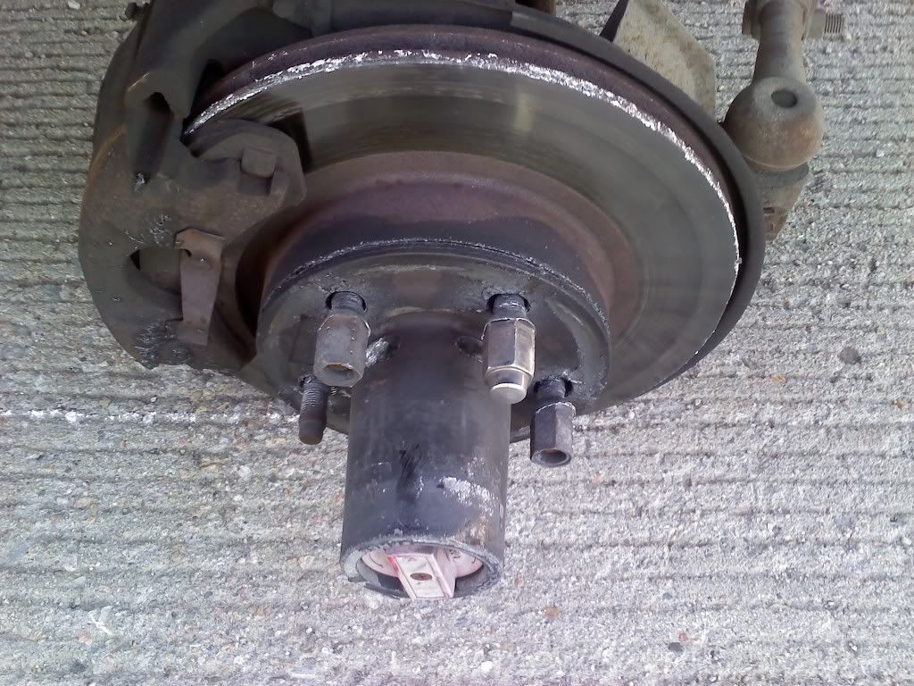

just thought i'd update you guys, unfortunately it's bad news....
was driving on the interstate and BOOM, next thing i know i see my tire bouncing wildly in front of my truck before it bounces off over the overpass down to lanes of traffic below (luckily didn't hit, or worse, kill, anyone). so then i'm like holy ****! so i pull over and my rotor is completely shot obviously, but wait... my lug nuts are still on there! WTF! well, it had to have ripped my entire rim and tire off somehow, OVER the lugnuts.... (well one of the lugnuts was missing, but that's all, strong head scratcher in my opinion)
I guess i'm lucky that i didn't end up killing myself, my mom, or anyone else on the road... but this whole thing today just kind of makes me wonder what ever happened to the whole "good things happen to good people" quote? because i can't seem to get a break for the life of me...
it's just extremely frustrating, because i was on my way to drop off like 5 folding tables, and then off to have someone look at my truck for the noises... JUST MY LUCK... like i said, extremely frustrating and depressing.
got it towed to a shop, they are gonna tell me what they would all fix and an estimate, got a friend's dad who races cars, and thinks we may be able to do it ourselves, depending on the extent of the damage that firestone finds... firestone might think it could have been a front wheel bearing? could that have caused my ENTIRE wheel (rim included!!!!!) to completely rip off leaving lug nuts and what not?

Wow, OMG. Yes, good things happen to good people. Had you been a bad person this situation would have been much much worse. This was NOT a wheel bearing. This was most likely caused by improperly torqued lugs. The lugs were loose and allowed for movement. This will enlarge the lug holes in the wheels and eventually the whole wheel and tire will come off and pass you going down the road. The good news is it's not too hard to fix. The better news is your alive, so you can fix it!
Wow, OMG. Yes, good things happen to good people. Had you been a bad person this situation would have been much much worse. This was NOT a wheel bearing. This was most likely caused by improperly torqued lugs. The lugs were loose and allowed for movement. This will enlarge the holes in the wheels and eventually the whole wheel and tire will come off and pass you going down the road. The good news is it's not too hard to fix. The better news is your alive, so you can fix it!

Your lug nuts were loose for a while. The 5 holes in the rim egged out, the wheel came off and you were left on the side of the road.
No failed wheel bearings, no failed rotor, no brake problems.
Loose lugnuts.
Your rotor actually looks fine to me but it couldnt hurt to replace it. You will at the very least need a new wheel and new wheel studs and lugnuts.
