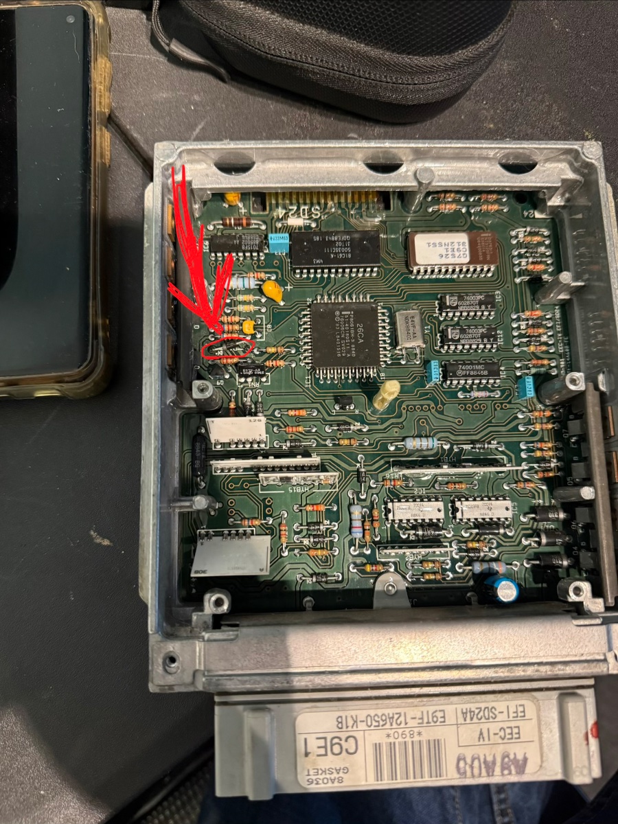

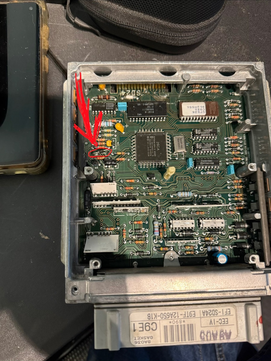

Since the new eec was from a ranger, I was not getting an overdrive gear so I took apart my old eec to see if there was a blown cap but didn’t see anything.
I checked all the diodes on the board and found a shorted one, after replacing the shorted diode I was back up and running.
