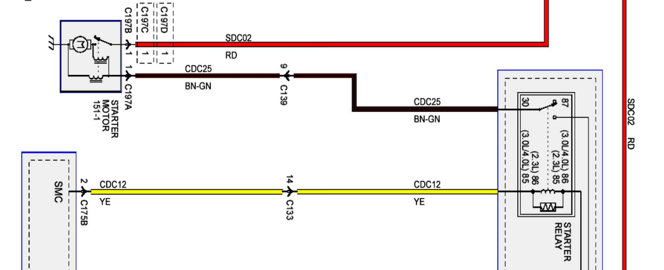

So I've recently just put in a new engine and I'm getting nothing, not even a click from the relay (relay works). I've connected 3 ground wires located by: ECU/PCM, ~Brake booster to head, Starter stud. I've been using the pinpoint test from the factory manual: https://charm.li/Ford/2007/Ranger%20...20Not%20Crank/
By that manual I am on A7 (Is resistance less than 10k Ohms?). I have OL between starter relay pin 30 and starter stud ground. Instructions state to repair circuit CDC25 (BN/GN) for a short to ground. So far I've checked for continuity between the starter S terminal wire and relay pin 30 and fuse 7. Both check out. Clearly I'm missing something but I have no idea, electrics is not my strong suit.
Here is the diagram of CDC25.

OL on your meter would be a open or resistance infinity, not a short.
If the meter is confusing, what you can also do is find the brown/green coming from the starter, and jump it to ground. MAKE SURE YOU ARE IN PARK OR NEUTRAL). When you jump that to ground, the starter should crank the engine. You can then move up to pin 30 on the start relay and jump it to ground there. If the starter cranks the engine, the brown/green is good from the relay all the way to the starter.
If the starter cranked when the brown/green was jumped at the starter, but will not crank when the brown green at pin 30 is jumped, then you know you have a problem with the brown/green wire between the starter and the start relay box.
it must be too early for my brain because step A7 makes no sense to me.
skip to A8
power from the relay goes into the S terminal on the starter, it goes thru the small solenoid coil then on to ground.
you can get power to the S terminal, but if cannot continue on to ground ( thru the starter ) nothing will happen.
take the wire off the S terminal and check for low resistance between the S terminal and ground.

Aaah so OL is either open or high resistance. So then if A7 is asking if resistance is over 10k, which is essentially an incredibly high resistance, then a reading of OL is equivalent to what A7 is asking? Starter relay was energizing when I manually put power to it. Man, ford manuals are confusing. Perhaps its because I'm coming from working on older Toyotas, whose factory manuals hold your hand the whole way.
What I ended up doing was replacing the ignition switch because I wasn't getting power to the ignition switch fuse. This was supposed to be like step 25 or something and I was in no mood of going through all the steps first. I intially forgot to the connect the ground by the brake booster when I first attempted to start, perhaps that did something because the car was starting before the engine replacement.
