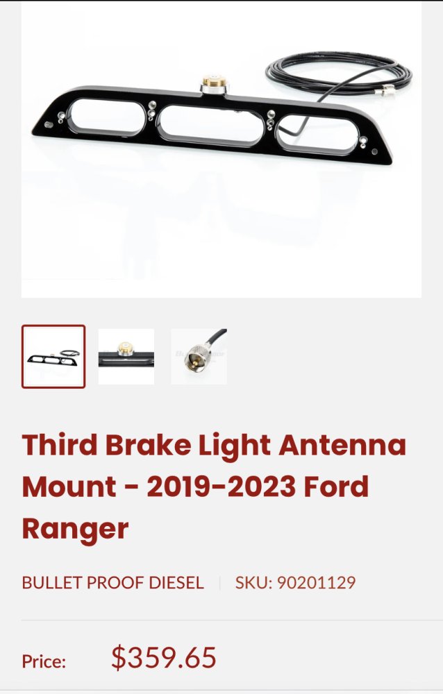

I was thinking about this for my new Ranger:
