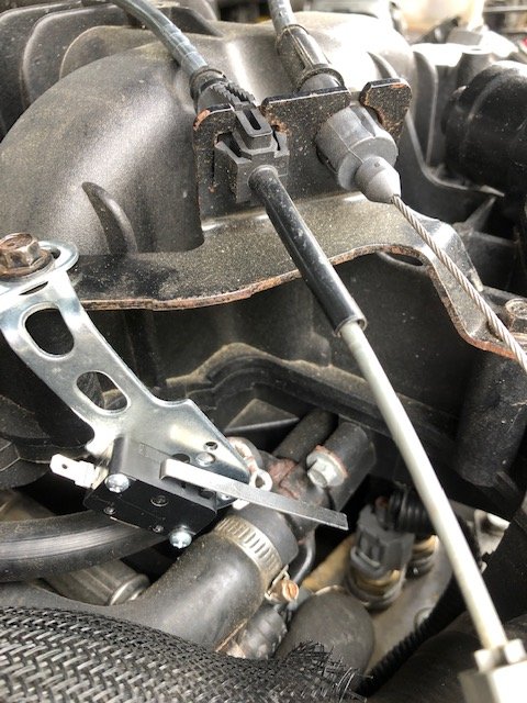

28482
Installing the WOT switch
28483
Align it so your throttle makes contact just before it stop but enough that it engages the switch.

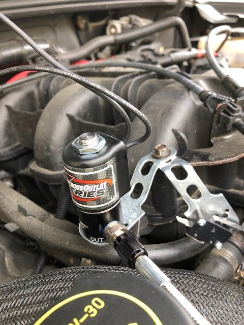

28484
Next I installed the nitrous solenoid. I use the same screw as the limit switch. Bend it down for hood clearence.

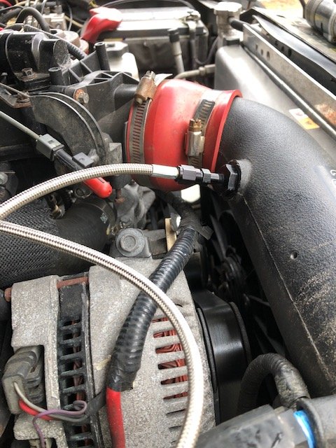

28485
Connect the feed line to the solenoid and the nozzle. My CAI has a threaded hole for the nozzle but you may have to drill a hole.
28486
The nozzle has a little dimple on it to show you which way the opening is facing so you can be sure it's pointing towards the throttle body.

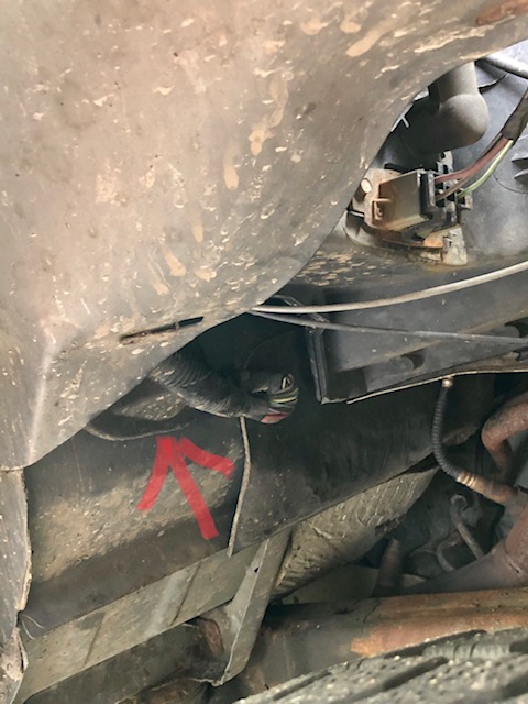

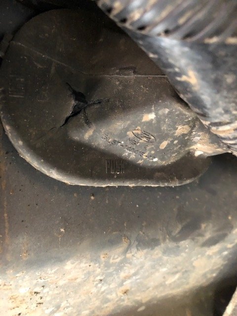

28490
I ran the supply line through a grommet located right behind the passenger side wheel
28491
Here is a close up. I just cut a small + into it.

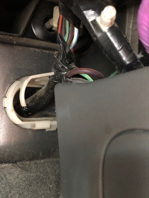

28492
This is the grommet right behind the kick panel.
28493
Before running the supply line, be sure to tape off the end so nothing gets in it.
