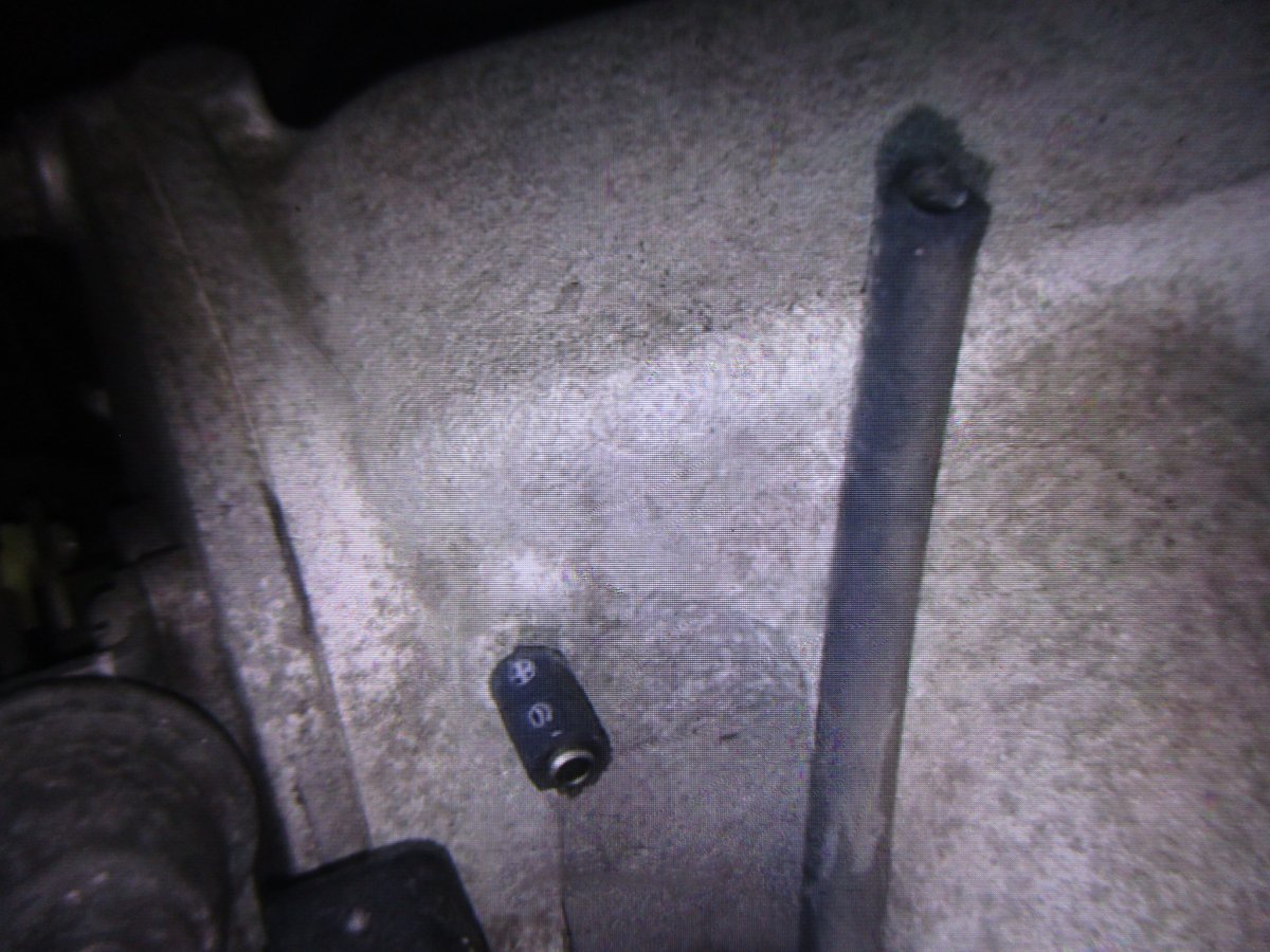

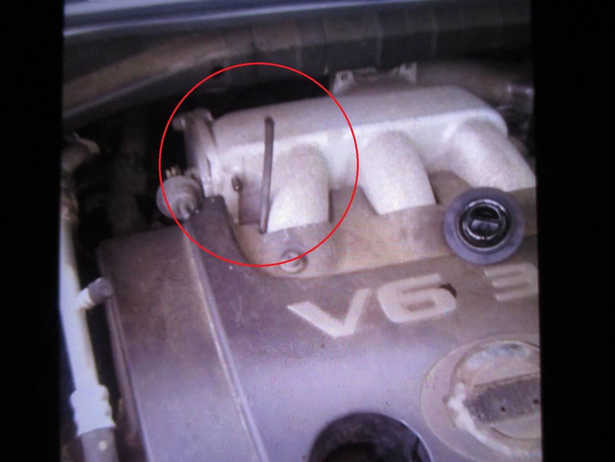

Also, any idea what this cut hose is? There's no slack to reattach and to see where it goes the whole engine has cover plates I didn't bother removing. Maybe I can just patch it to reattach. With engine running, if I put my finger over the nipple it attaches to, it sucks in.

That black hose could possibly go right there on that little nipple that has a small piece of black hose on it
Even if the exhaust is not smoking or you do not see a puddle under the car there could be a leak or it could be burning oil.
The hose is a vacuum hose, would have to follow it to see what else it's hooked up to. I would want to reconnect it sooner then later.
Vacuum leak could be causing one or all of your trouble codes.
the cam timing related codes were likely caused by the lack of oil to drive the system, the lean code is most likely related to the vacuum hose being broken off as was previously mentioned
