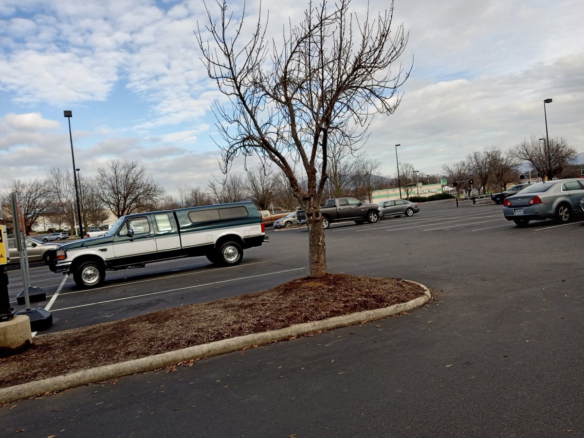

Check this clean, I believe, F250, long as an aircraft carrier. Dual tanks, 4x4, two-tone paint. If those are stock wheels someone might be able to tell the year.
Ahh yes, when trucks were built to do truck things with rather than soccer mom mall crawler family sedans.
Its an F250 by the looks of what I can make out of the emblem on the fender, and might say Power Stroke underneath. Definitely wouldn't mind something like that for the occasional towing duties. My uncle has my 88 F250 super cab 4x4 long bed with the 460 and C6 in it...still going with close to or over 700k on it by now....although it needs an overhaul the 460 last I drove it was getting tired. Should never have let my uncle have that truck he's done nothing but trash it. It'll pull anything, but it don't pass gas stations even with dual tanks you don't get far.
