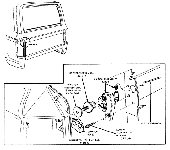

Came upon an issue...removed back panel and the rods are going back and forth but the jaws around the bolt won't open....thoughts?
And thank you very much!
Has that rod come out? See the attached picture.
