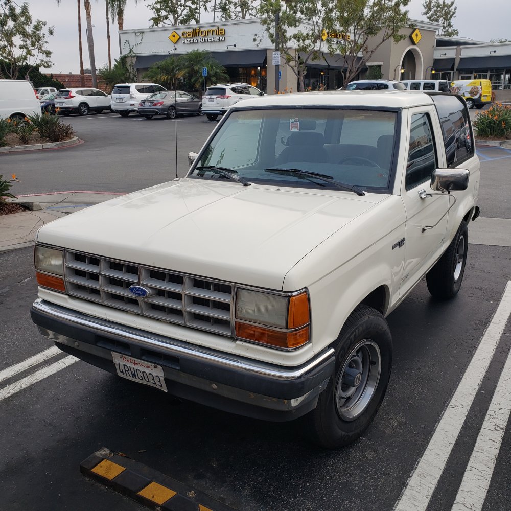

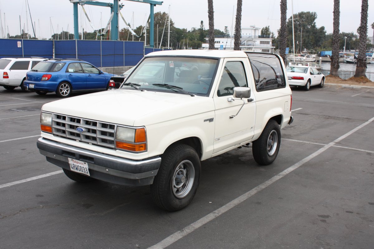

I ordered all new lights as well as NOS wheel caps for that new look. Also some spray paint in the original Colonial White (YY) to touch up some areas. The original paint has come back really well, after lots of elbow grease. I'm more concerned now about door dings than on our 2011 BMW! And the compliments from neighbors here in the marina (we live on a boat) just keep coming.
....seems like its giving you troubles....can i have it?.....
