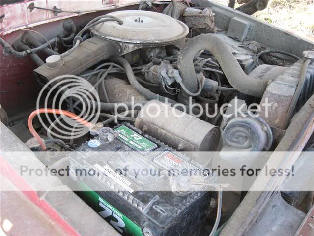

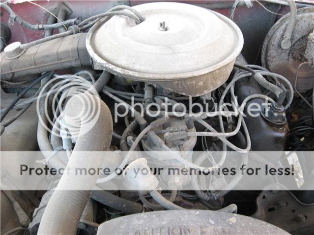

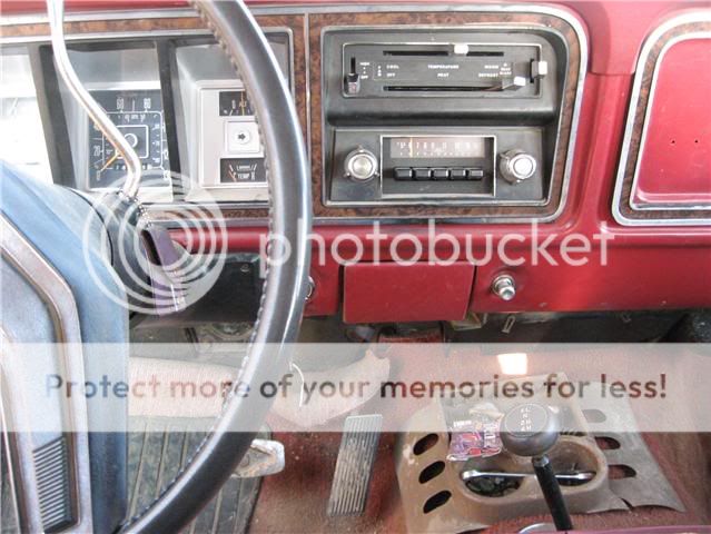

got him to send more pics

Actually the 351M and 400 was decent engines. The 400 more so then the 351, but neither one are bad.
People consider them big blocks because they use big block mounts and bolt patterns. There not really a "big block".

Big block, small block is a Chevy thing. They only had two V8s.
The 351M/400 has the same deck height as the 460. Since they are both 90-degree motors, the width is similar. They both have 3" mains. They share the bellhousing pattern. To me, it's really just the 400 motor and the 351M is the bastard step-child. The 351M is an accident. The 400 was the real goal of that project. The 400 is, to me, a big-block. And since the 351M is a 400 with a 351W crankshaft in it, it's also a big-block, if you want to use Chevy-speak on your Ford.
The 400 motor is something worthy of respect. All 351Ms are crying out in the dark, longing to be reunited with their proper cranks and pistons. They were wrongfully denied 49 cubic inches by Ford. It's an injustice. And it's a pretty cheap power and torque upgrade that is guaranteed to give results.
An M in good running order will actually outperform a windsor of the same vintage in something like a truck or bronco. The M's were tuned for low end torque.
But yes, i agree, the 400 is a better engine for performance.
On the flipside, it has the same bore spacing as the cleveland and windsors. You can switch the heads and cranks between them with some minor work.
Not much else interchanges between the traditional SBF's (302/351W) so it isn't really fair to call it a small block. Nothing is the same as a traditional BBF (429/460) so really they kinda need to be in their own family... kinda like the FE series.
