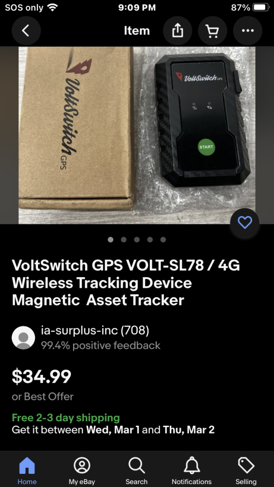

I looked it up, dont know what the monitoring costs would be but the gps device itself is $100. Can find them on fleabay for $35.

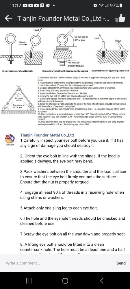

So I saw mention of using eye bolts for tie downs and I would strongly recommend against this if you’re intending to use hardware store eye bolts, they aren’t truly load rated. Rated eye bolts are more expensive, and I never much liked eyes sticking out potentially in the way. Much better to use D-rings for tie-downs, they lay flat when not in use, TSC and other places have them, and they are load rated. I bought some 3/8” weld on rings and there is 7 welded on the little trailer, three across the front, one on each side in the middle, one in each back corner, and I welded nuts in place to bolt one in the center of the rear (that way a mower deck doesn’t have anything to catch on but the ring can be bolted I place quickly if needed). I also put stake pockets around the edge and with the way the C channel frame is, I can hook there too.
Are load rated eyes forged or something? And hardware store eyes cast?
Yes. Load rated eyes are forged. Their load rating is much, much higher than cheap bent rod eyes. But they still must be used properly to retain the ratings.

Hardware stores do sell load rated eye bolts as well. At least True Value stores do. I have a few installed on my trailer where it matters. Otherwise, I have rated, recessed rings on the deck and on the walls. All bolted into the frame or reinforced sections of the walls.
In any case, they have a load rating cast or forged into the ring and the ring is a solid ring instead of being a bent rod.
I've used the smaller D rings on small trailers from Harbor Freight with good results, I have a bunch I need to add to my 5ishx12' trailer but when I built it I put a angle iron rail around the outside so most stuff doesn't need anything fancy... The bigger D rings from HFT and the such are just meant for 1/2" carriage bolts so aren't rocket surgery to install (but I never seem to remember to install them somehow even though I have a bunch of them too...)

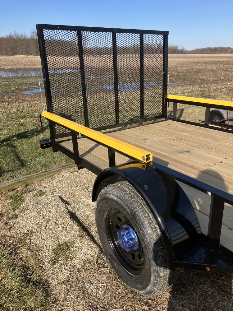

Well I “sprung” for a gate lift assist. lol Found one on ebay for $125 (vs $250 @ tsc) so I ordered it and just got it on today. Works well. Theres 2 coil springs in each yellow square tube, one inside of the other. Next will be either sideboards on the inside of the rails or tie downs.
