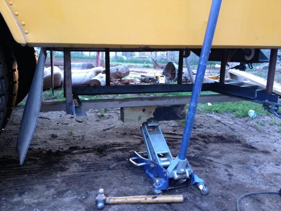

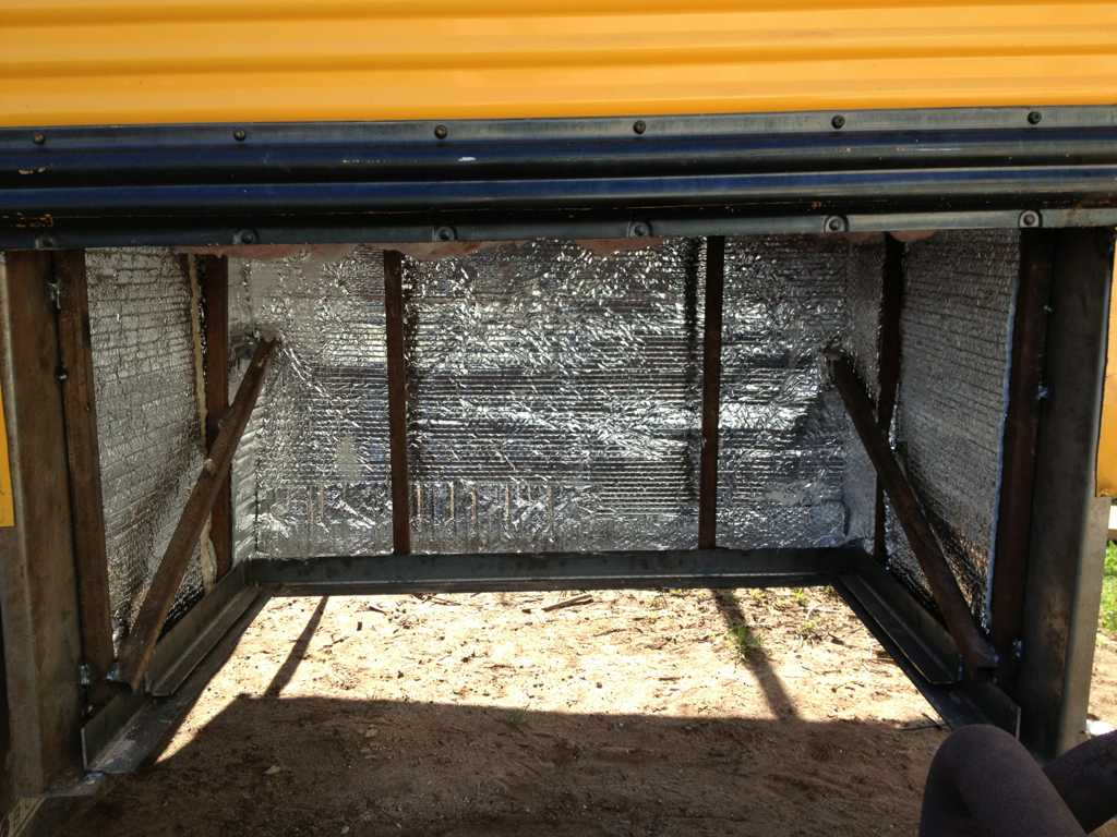

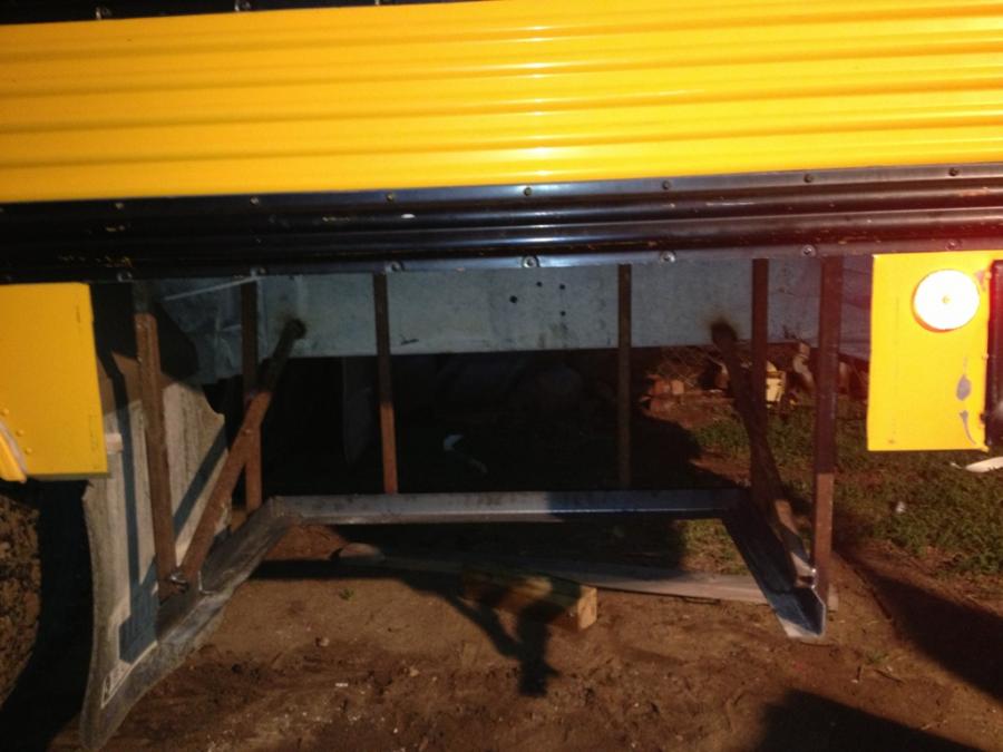

Genny box is started, now just gotta box it in with plate.

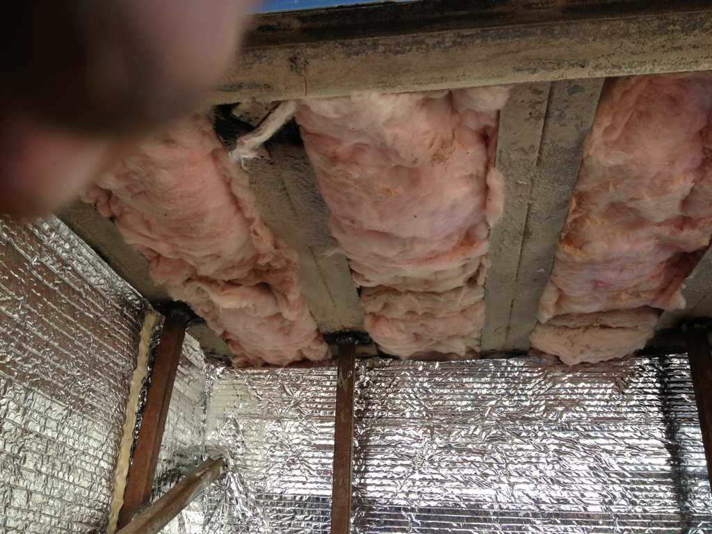

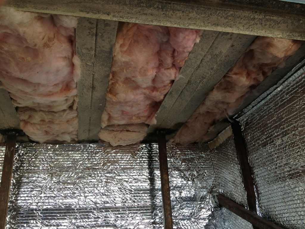

Genny box done and insulated.

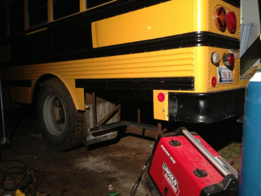

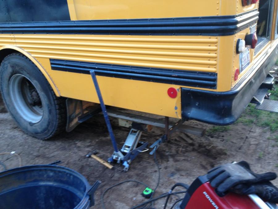

Going to extend the tip out to the edge of the body, but other that that,,,,,,, exhaust is done!
Stock 09 FSD minus the muffler, even the differential hump was in the right spot!
