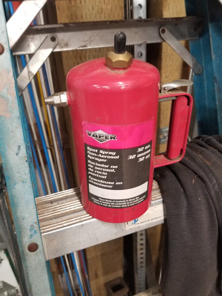

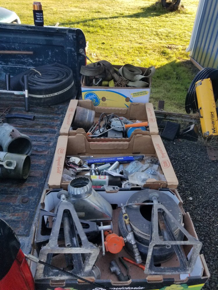

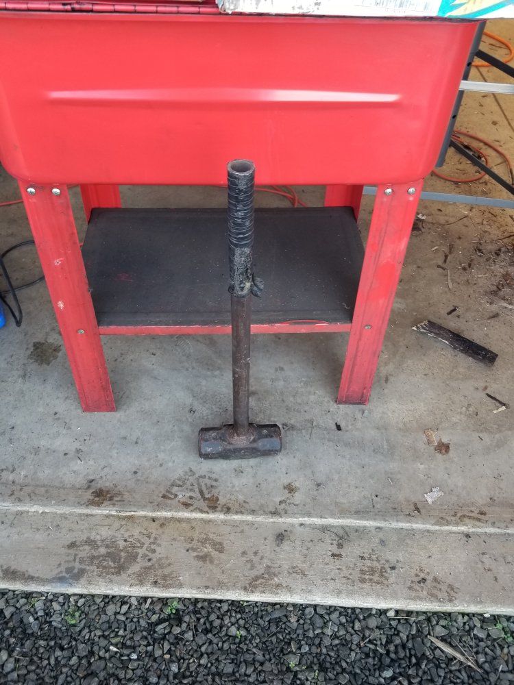

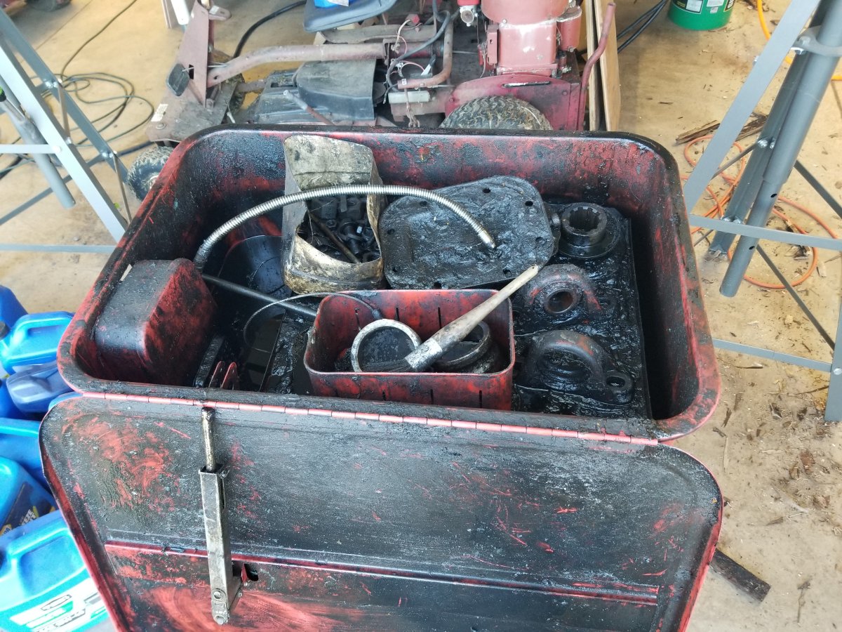

Finally hooked the phone to the computer so here's the haul from that auction a couple weeks ago, yes the parts washer is a mess :). Aside from that the other day I got a purple HVLP spray gun from HFT the other day to spray the contact adhesive which worked ok, needed a bigger nozzle but we made it work... today I ended up at HFT since the wife was getting a hair cut and got the Bauer cordless flex shaft rotary tool deal, it's pretty nifty, might just use it more than the dremel... The sprayer thing with acetone apparently has a leak at the fill cap somewhere as it doesn't hold pressure long, it drains down to a couple psi fairly quick but doesn't leak liquid, the valve core was half a turn loose so I thought that was it but it wasn't...

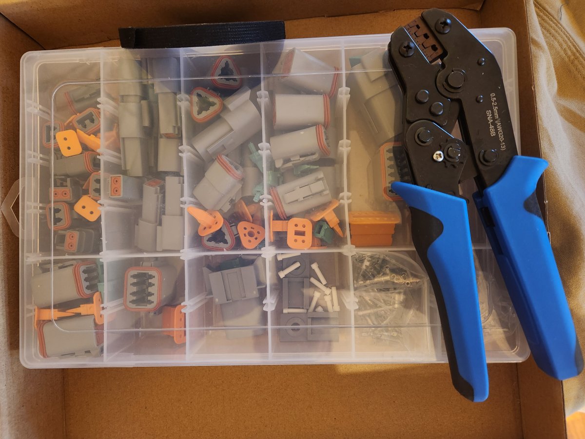

I've always been a weatherpack kinda guy. But the price was right enough that I thought I would try these...

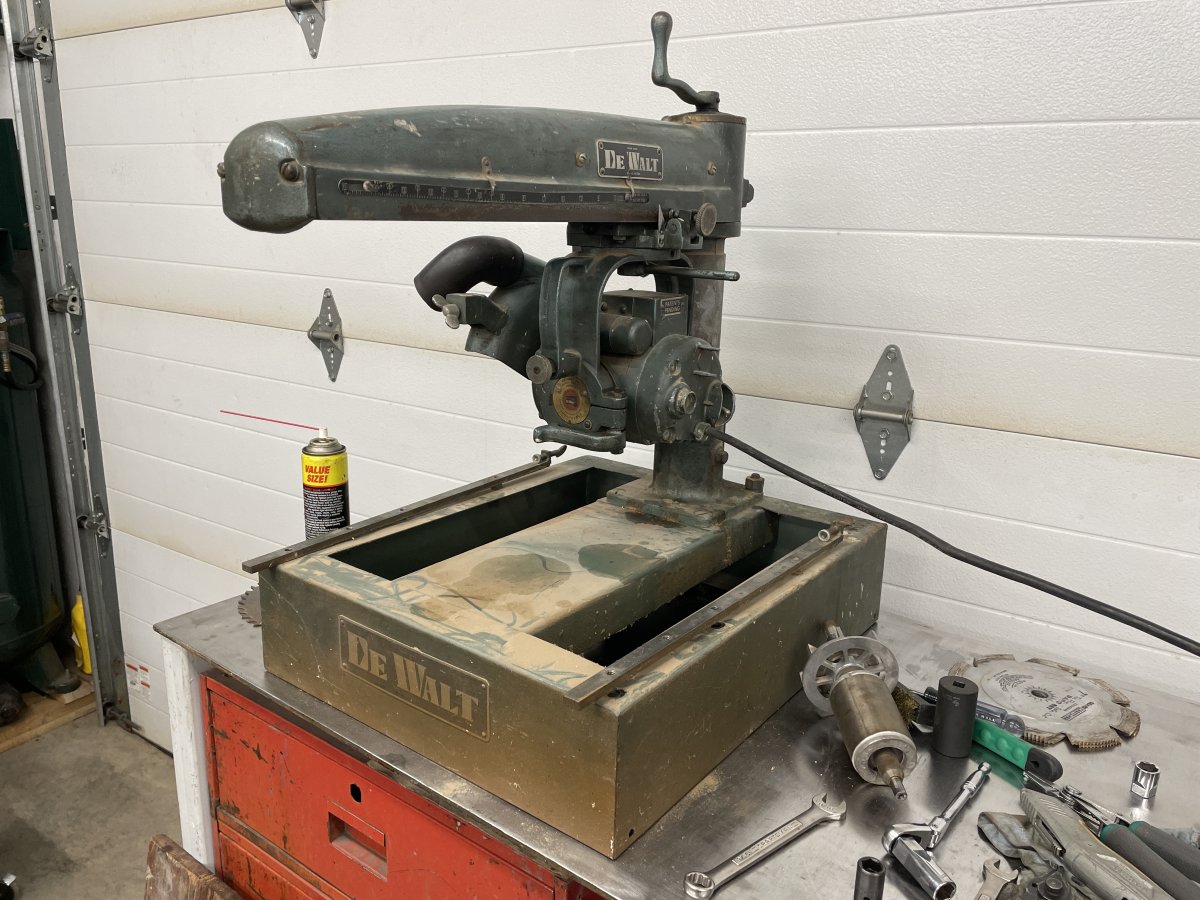

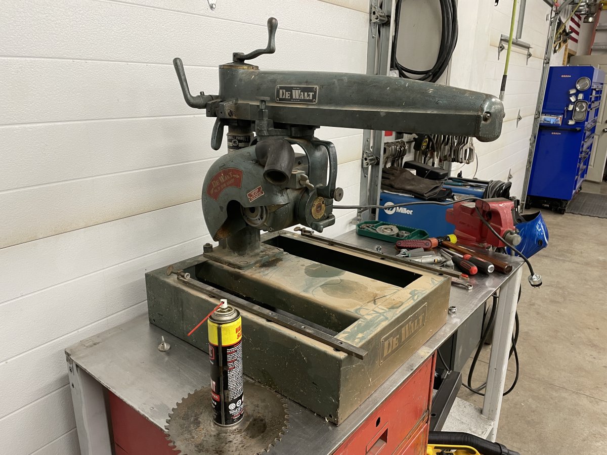

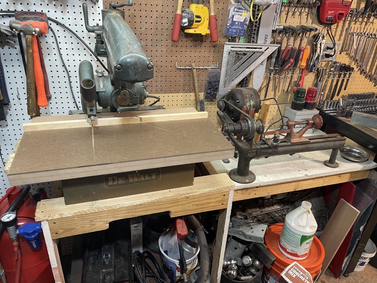

I mentioned this elsewhere but I bought this 1940's DeWalt radial arm saw at an estate auction for $1.26 after fees & tax. @alwaysFlOoReD thought it was pretty cool:

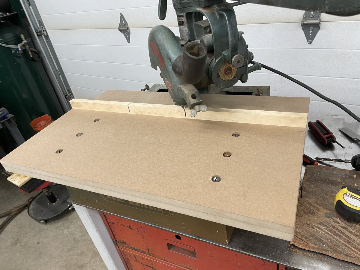

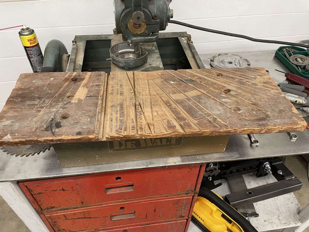

It needed both bearings in the motor replaced and a new table. Bearings were easy, about $20 worth of parts. The table was a challenge, this is what I had to start with:

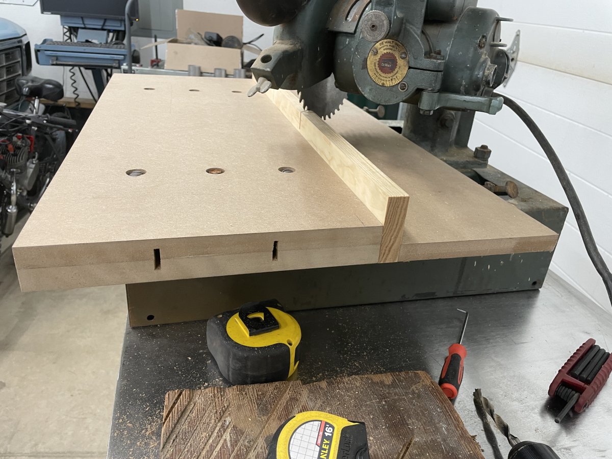

After spending a few hours studying these I decided to build a "Mr. Sawdust" table which is basically two pieces of MDF with steel bars epoxied into slots to keep the table from bowing. I had a 28" wide piece of scrap MDF so that's how wide I made it. Cut a couple other pieces up for the back pieces as well:

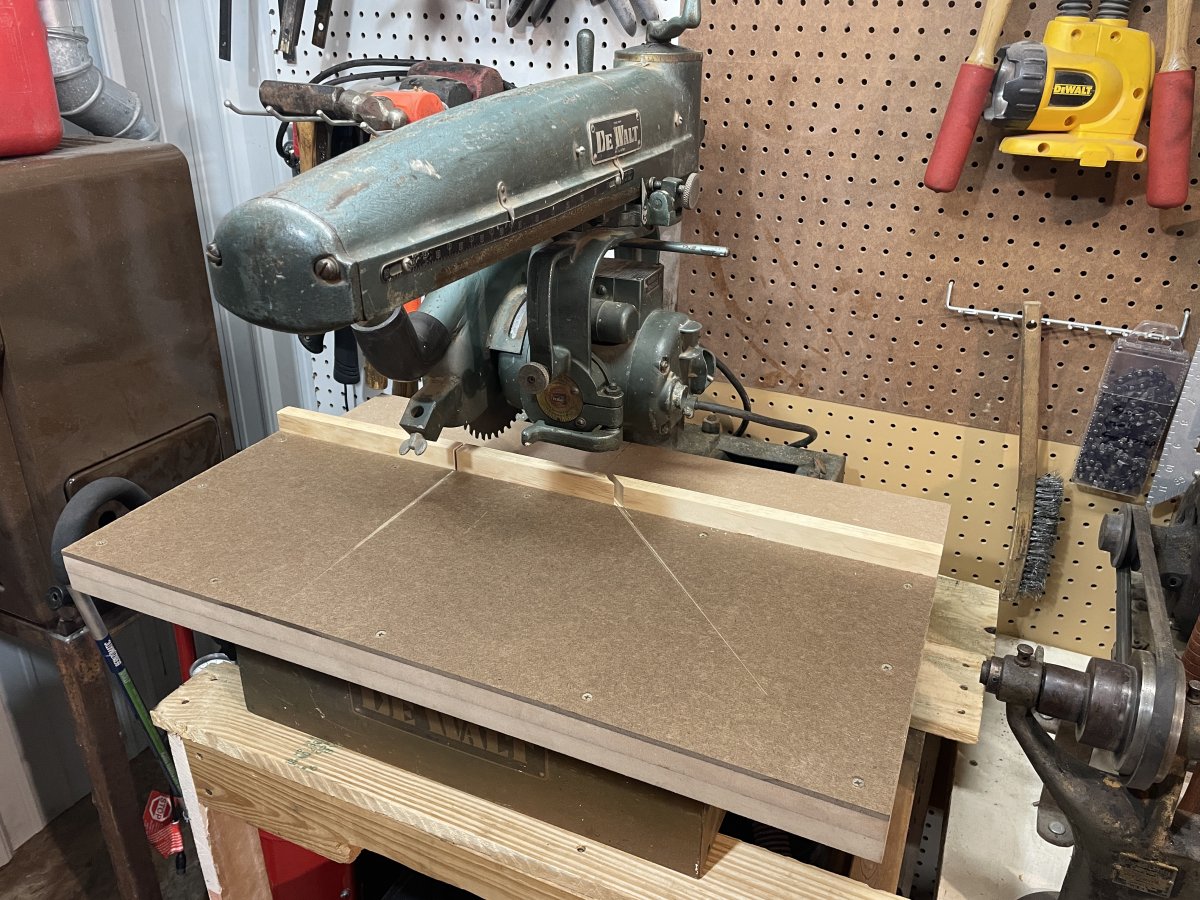

After assembling the whole thing I realized that straight cuts will be fine but angles will start with the blade slightly into the back block piece... should have done that differently but it'll work. I ran a whole bunch of test cuts and had to run the table through the planer to get it flat but eventually after some adjustments on the saw itself, I was able to get a nice straight cut. Then, I moved it over into my wood shop shed and made a nice masonite sacrificial top.
It is right at home here with some of my other ancient woodworking tools. I need to built a better stand for it, this one is actually for my blasting cabinet but that thing leaks so bad that I might just get rid of it. I like this saw way better. Need to get an appropriate blade for it but it'll work for now.

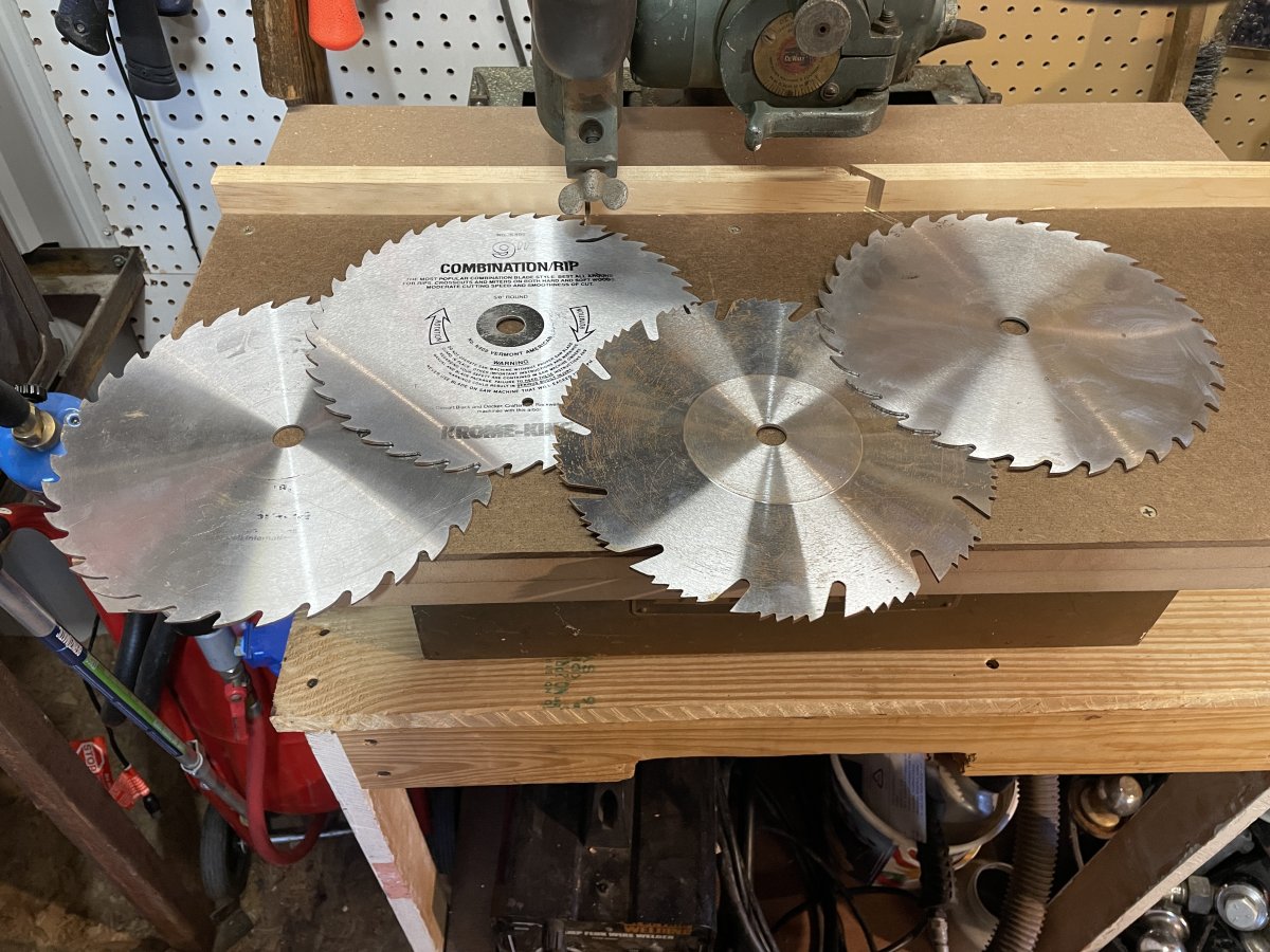

Less than 24 hours later, I stop by my favorite thrift store and score four nice 9” RAS blades for $5 each!!! Someone, probably some poor old fella that died, dumped a bunch of tools there. Unbelievable, I was debating spending $60 on a new Freud blade…. These are old school non carbide blades but they will work perfect for my purposes!

Be careful, those are all positive rake. They will have a tendency of grabbing. Negative rake of a couple degrees is what I've read is best. You could probably hand file that into those blades...
