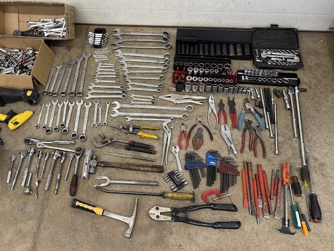

I bought a whole crap ton of hand tools on Marketplace on Monday. The seller was an older lady who said her husband retired as a mechanic and was selling off his tools. She offered me the lot for $150 and I countered at $100 and left all the power tools and a couple boxes of stuff I didn't want. Main thing I wanted out of the lot was a handful of Snap-on screwdrivers and extensions, some specialty engine assembly tools, a handful of large wrenches, 3/4" impact socket set, a nice come-a-long, and a few other things I'm forgetting.
This is what I didn't want, I added a few things to the pile and am going to resell it and break even. Another weird lot, maybe this was just his "extra" tools, but a lot of mixed up weird junk and no full sets of anything.

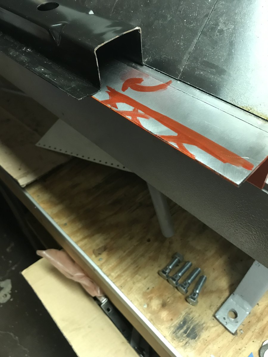

determined I'll have to obtain a narrower blade for the finger brake.
the blade will need to rotate up into the channel when I replicate this piece.
I hope the lower section will clear. I'm kinda still learning this.
if I widen the center about an inch it can be inserted up-side-down but will still need some trial 'n error.
Use some 1" strips to try different bend orders. Tho I can't think of one that will work for you. My brake is made for aluminum sheet used for cladding, and it sticks out 3/4", but 10.5' long.
Tell me why you can't cut down the stick out that's in your way? I modify tools all the time.
I could, but I'd rather get another piece of angle and trim it to fit.
it's only a piece of 2" angle, precision ground to probably +/- .002 at best. 7 bolt holes.
I should be able to trim down another one.
good excuse for another trip to the steel store. :icon_thumby:
that black piece is a NOS under-bed support.

How much metal is behind the fingers? Can you do both the outer bends first then the inner bends? would gooseneck fingers help?
for an exact duplication I have 2 hangups.
1. after the outers are bent the piece needs flipped over. the fixed blade is only 1/2 tall, I want 3/4 so a shim will be needed on top of the fixed blade.
2. the first inner will be ok, the second will contact the fingers well before 90 degrees, with the 2" center. if the center is widened to 3" I can get a full 90 bend.
or,, those goosenecks.
or,, a substitute clamping plate instead of fingers.
it will probably work with narrower 1/2 wings and a wider 3" center. but who wants to do it the easy way. :icon_thumby:
lemme go see what's in the shed.
