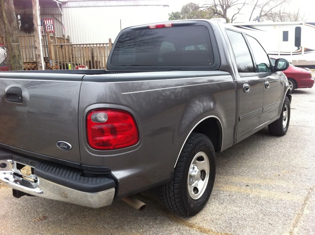

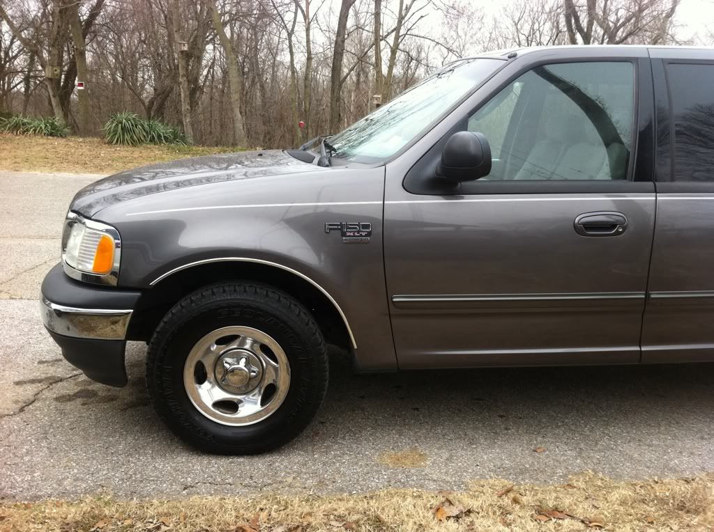

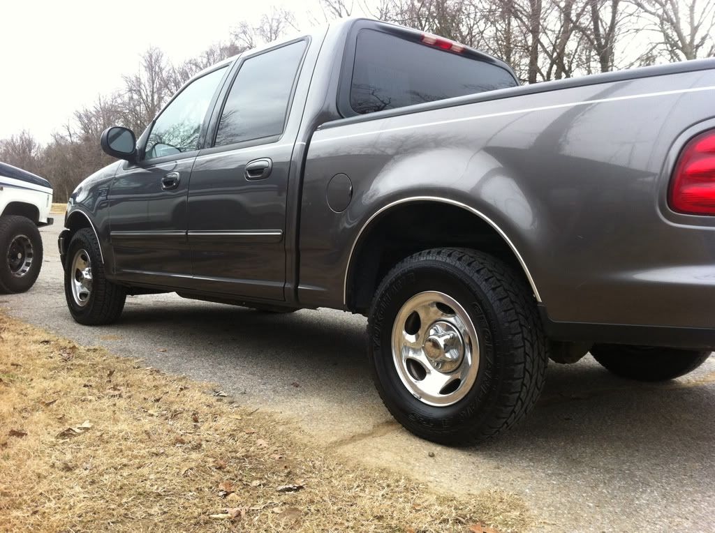

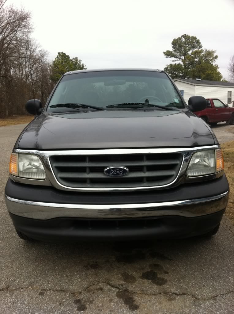

We finally bit the bullet and replaced that money pit chevy silverado. it was a nice truck overall we just wanted something newer.
so we got this...
2003 F150 5.4
Crew Cab
Auto
2wd :bawling:
3.55 open :bawling:
but its a major step up, and my father is happy with it.
maily a DD, but will pull the atv's, boat, and camper when needed.
now the important part...pics!
i'm extremly happy with the deal we got. plans are simple...
air intake later on, exhaust, and tuner
also.. LineX the bed, install ham radio, paint some of the faded plastics.

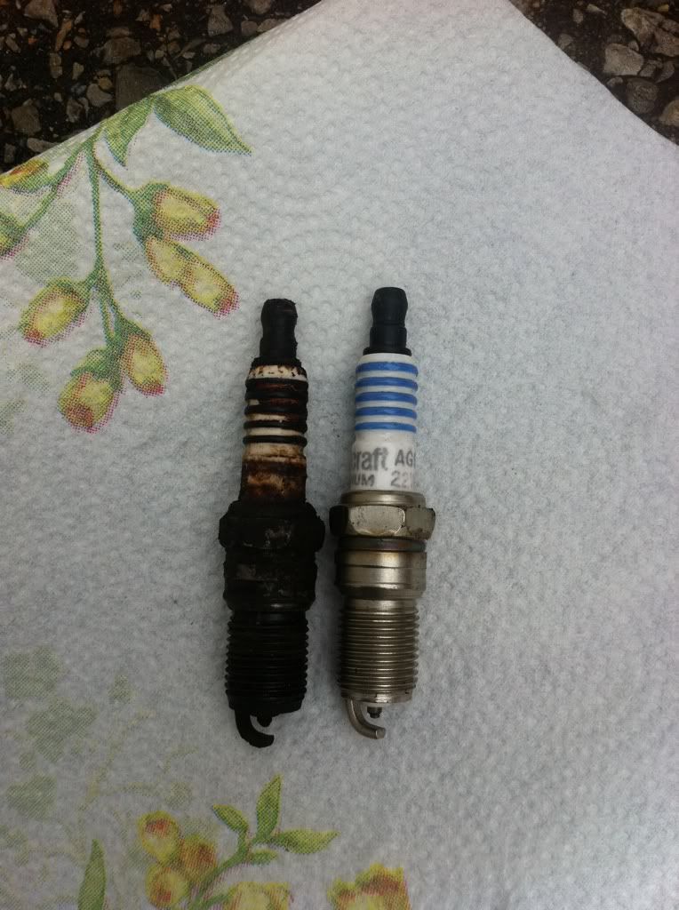

old--new... yeah, that was the cleaner of the 2 that we pulled at that time. they really needed changed
all 8 coils and plugs will be changed. number 7 and 8 was changed yesterday since it was giving us a CEL code. all others will be changed saturday. its running great now tho.
