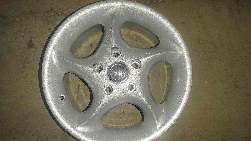

I found some 15 wheels on CG and I see that it has the right dimensions and the bolt patterns. I am still unsure if the offset number is OK? It's not to the "ideal" on the guide... There wasn't much information on the ad. I have attached the photos.
Any ideas on if it will fit? Or what other measurements should I look out for when purchasing? I should probably measure the center post hole?
I'm finally understanding offset numbers.. SO more positive the offset, the narrower your stance. I thought it was the opposite. I'm guessing these wheels are going to be too tight.
That offset equates to about 5.3" of backspacing. Most stock ranger wheels iirc have 4.5" of backpacking, so probably a little tight.

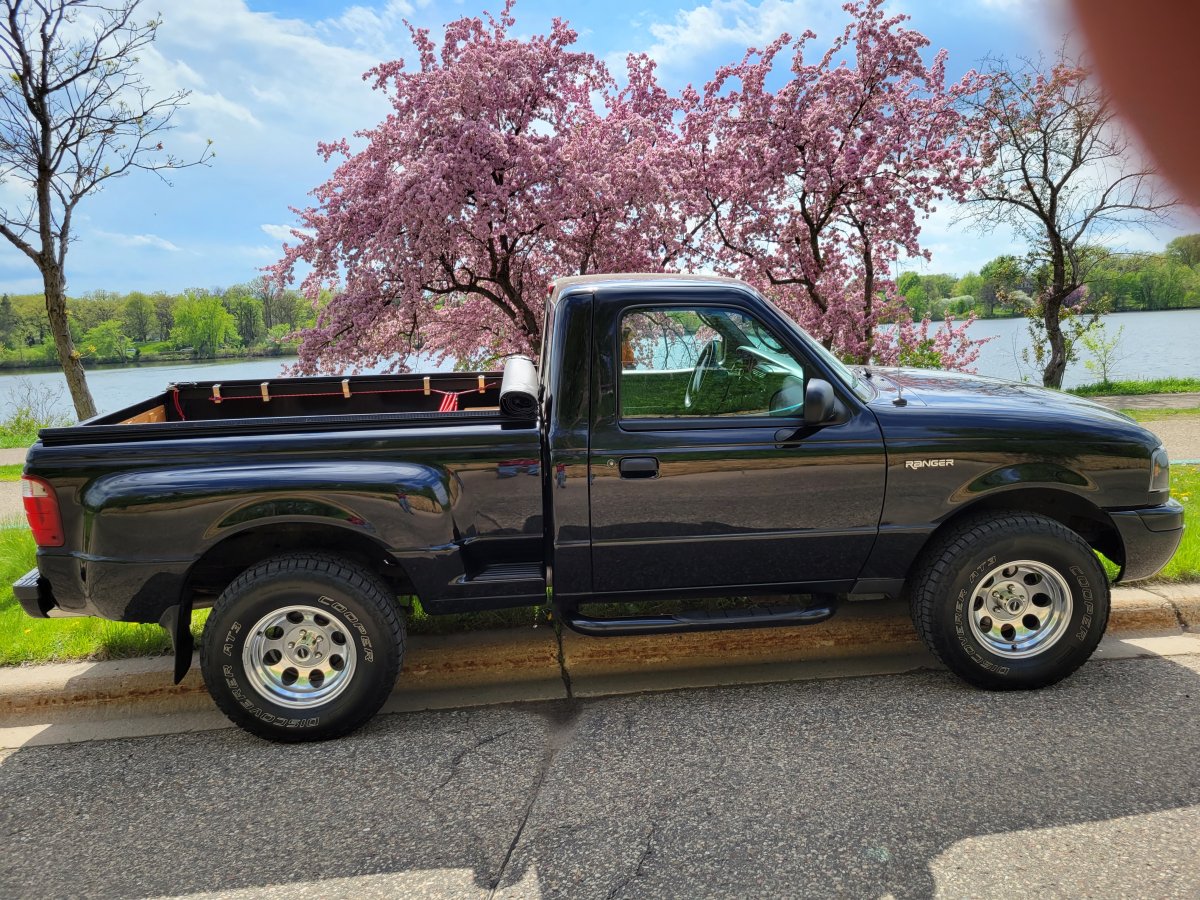

I think these are the wheels @Lefty bought. But maybe not. Great price on them right now either way.
They are 8 inch wide with a 3.75 BS. Which means it would be 1 3/4 inch wide per side. These are lug centric (at least my 16's are).

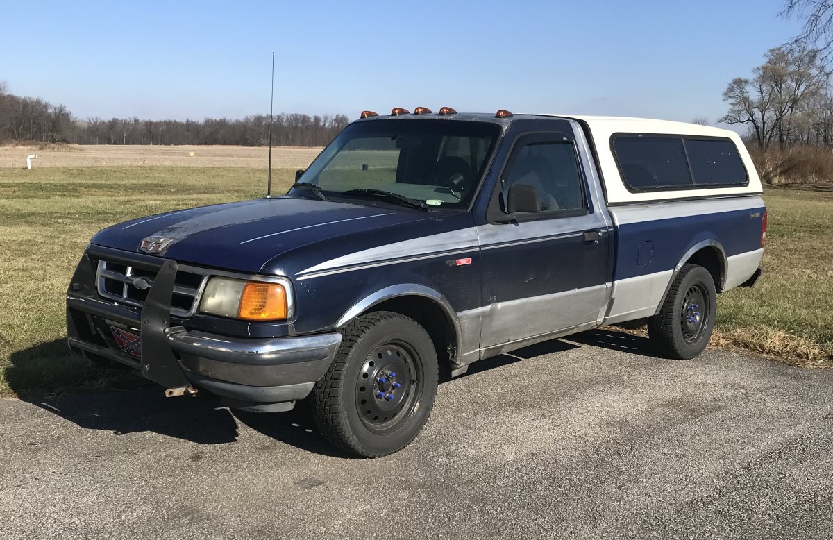

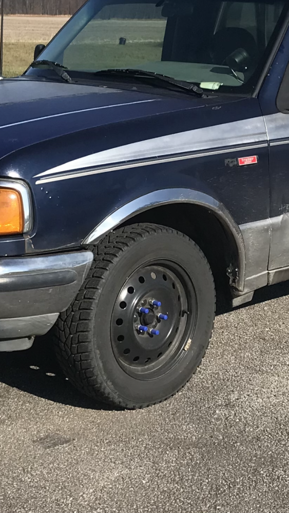

Im running fwd 16” rims at the moment, with adapters that are 1-1/2” thick. Im normally not a fan of this but it was one of those things that made sense expense wise. My winter beater hhr had started some internal knocking noise, I decided to stop driving it, I had a spare set of factory steel rims with 2 year old winter tires on them. The bolt pattern on these wheels is very close to the ranger but not exact. I think its 5 on 100mm. I found a set of adapters on amazon for $200. The winter tires on my ranger winter wheels were in need of replacement, still had decent tread but were past 10 years old. Sure I could of got 16” rims for the ranger & had the tires swapped over but overall I feel this was the cheaper and simpler way to go. The thickness of the adapter made up for the positive offset of the fwd rim. Yes they dont look cool, I did add some silicone vaccum caps to the wheel studs, just for looks. The smaller overall size has my speedometer off a little, about 6mph is all. Original stock size was 225/70/14, My other set is 235/75/15 and Ive got the speedometer set up for that size, the other set of tires that had been my winter set was 225/70/15’s Whats on there now (hhr rims) is 215/60/16. My original gearing was 3.45 its now a 4.10 Overall I feel the best size is the 225/70/15’s. the 235/75’s are just a bit too big for the 2.3 4cyl, only so much torque there, even with 4.10’s. The hhr set being a 60 profile ride kind of rough. Dont think they woild be happy with a big load, wouldnt want to with adapters anyhow. I do have about 400# of softener salt in the bed. Between that and the cap its plenty of weight for the winter.
