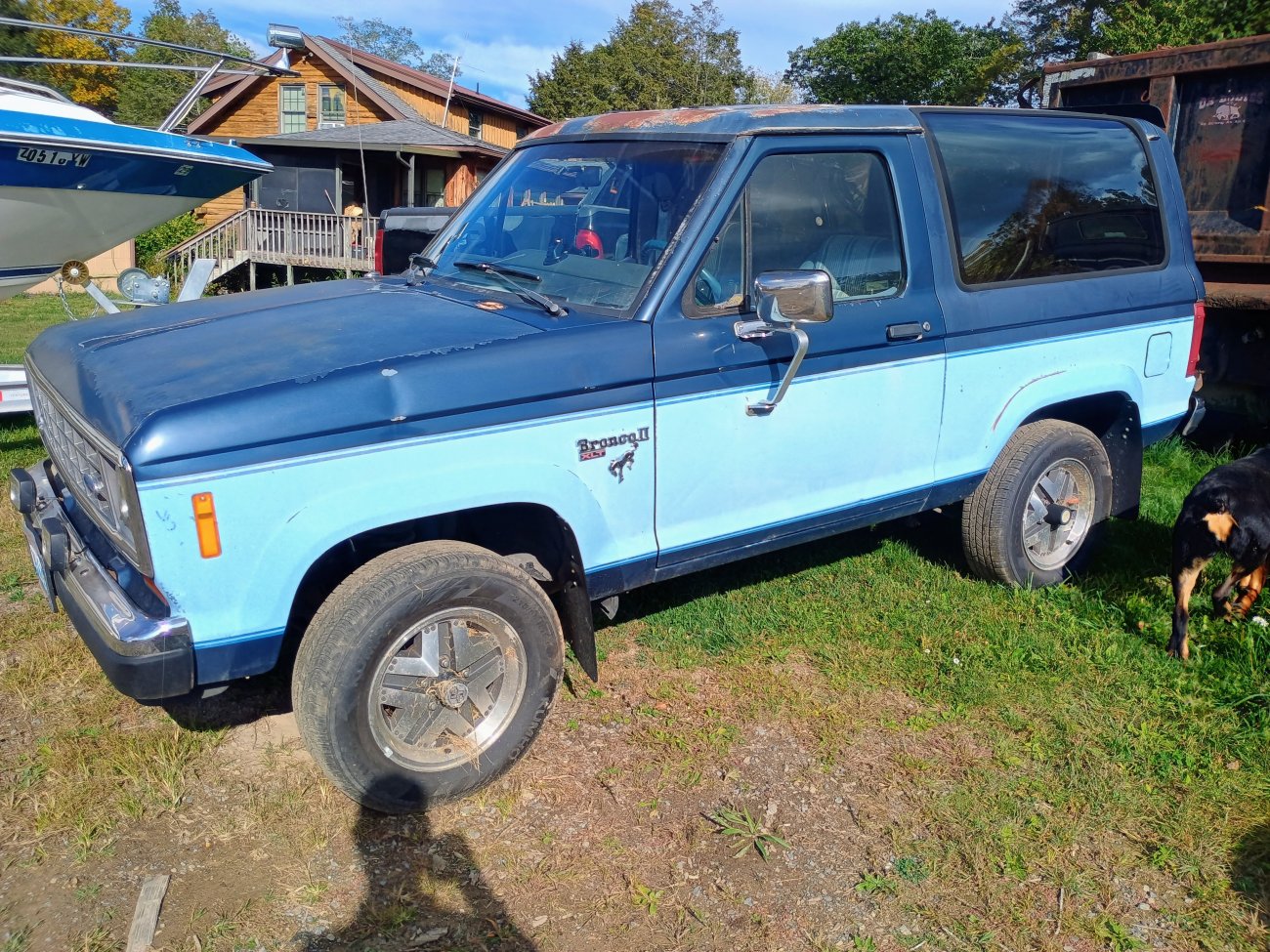

I have a 1986 Ford Bronco 2 XLT with the Automatic 4x4, with only 45,000 miles. I am having trouble with the engine mainly with the RPMs. I can't get it past 2500 while driving. I think it might be a fuel issue. I am a young guy and could use some outside wisdom. Any help would be appreciated.
Grace and Peace.
(Also, I can't seem to find any information or other pictures of this color scheme)

Two tone paint schemes were pretty common on the Bronco II, I have parts off a blue and silver I scrapped years ago and my 88 is blue and tan (Eddie Bauer scheme). Also owned an 89 Eddie Bauer in blue and gold.
