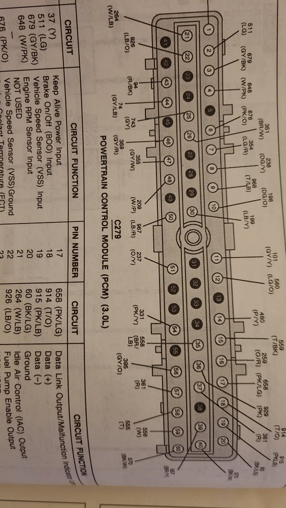

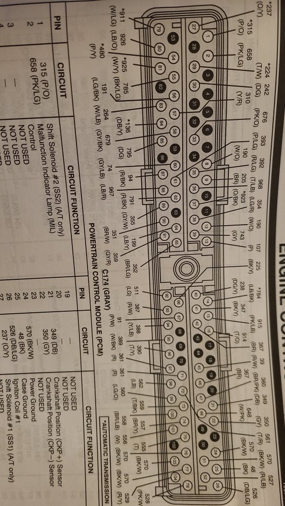

Could be remanufactured, like Sheepherder said. Otherwise, the differences between a 1991 OBD1 pcm and a 2003 OBD2 pcm are great. This is what the connectors would look like. The difference between about 60 pins and 104 pins. (These are for different engines, but you get the idea)
OBD1
OBD2
OBD1
OBD2
