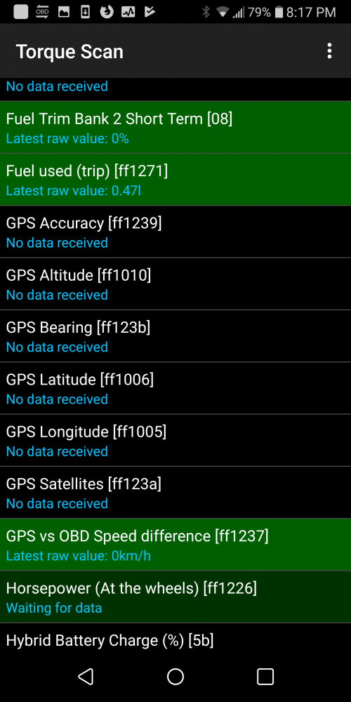

Used TorquePro, here are screenshots. I am trying to learn what all this means. But if you guys can offer your insights I would appreciate.
I drove around to let it warm to operating temp. Before driving off idle was not smooth. In fact engine stalled immediately after engaging reverse. It almost stalled at the first stop light, had to give it a little gas. I no longer have any codes (I had cleared the p0174+p0171 after previous full tank with techron cleaner), driven 34 miles, and no CEL has appeared. Anyway here are pics @ idle after returning
I noticed o2 sensor 2 was constant @1.27v. The others were bouncing between 0.54v, 0.49v, 0.73v.
Also noticed total number of misfire - 38. What does that mean?

Here are pics @2500 rpm. I did mash gas and I think I saw LTFT drop to a 4.26 then climb back to 21%ish.

The downstream sensors should not switch the way the upstream sensors do. If they do that means your cats have failed. Ignore the misfire monitor.
You're fuel trims are extremely bad and the CEL will return soon.
