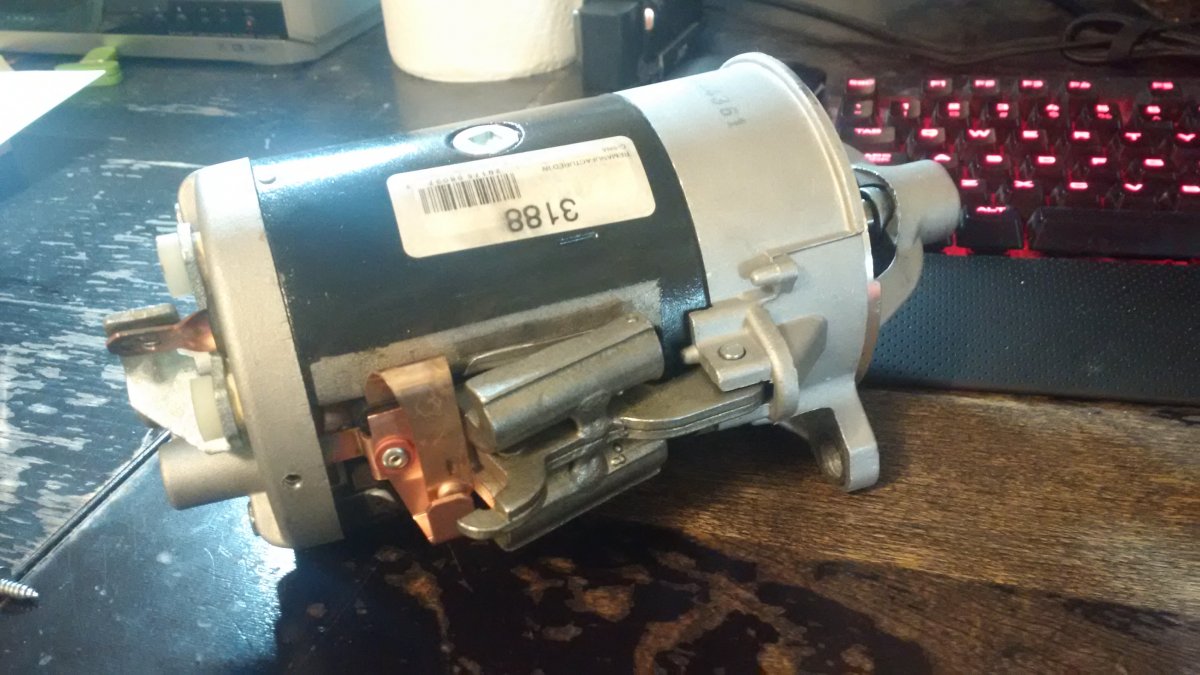

New starter grinding and "engaging" Engine is be turned somehow. 2.8L V6

What do you mean by pop off the cover of the sol? I can try and take and post photos or videos on my rig?

the solonoid cover....
i had a bent screwdriver that was a lazy solonoid helper...
oh ok! Well Ive popped it off.
- Video of it in action.

dont short it out prying on it....
does it work 100 on the truck when your watching it...??
What do you mean by? Both things? Im confused... .
watch it. does it work? if not you can pry down on the backbone or see-saw depending on where your from... to engage the ring gear.
it is drawn down with current..so look carefully at how it works to keep from shorting it out.....just pry on the back bone...
when its on the truck of course
OK, So I need to bend the copper connections up or down? I'm still confused. Sorry
And when Its on the truck, This solenoid is on top. Meaning I cant gain access to it phyicially or visually when it's bolted on. Thats what Im confused by. Because I dont know what i should be doing when I cant see the solenoid while its mounted.

you can see it on the truck.....dont mess with any tabs.
when i said bent screwdriver...i meant it....long driver bent to hook around covered with electrical tape. you can wedge the arm to engage the pinion if its not doing it on its own.....
but. not sure its a good idea to tell you that.....make sure there is someone controlling the vehicle.
on my 302 it was easier then with a 2.8. considering i have held starters in place before to start these things when the loose bolts broke off there isnt much there...
just manually checking it with no power should at least confirm it can go full stroke...
Sorry for my confusion. I couldn't tell if you were talking about using a bent screwdriver to adjust something or to manually move the pinion. Thats where I was getting lost.
When I say I can't get to or see anything that's regarding the solenoid. I meant it. On the 2.8 the area around it and SUPER cramped. I might do what you suggested with pushing the pinion out with zero power and do it manually and see where it lands and goes. That could be something I could attempt for sure.
