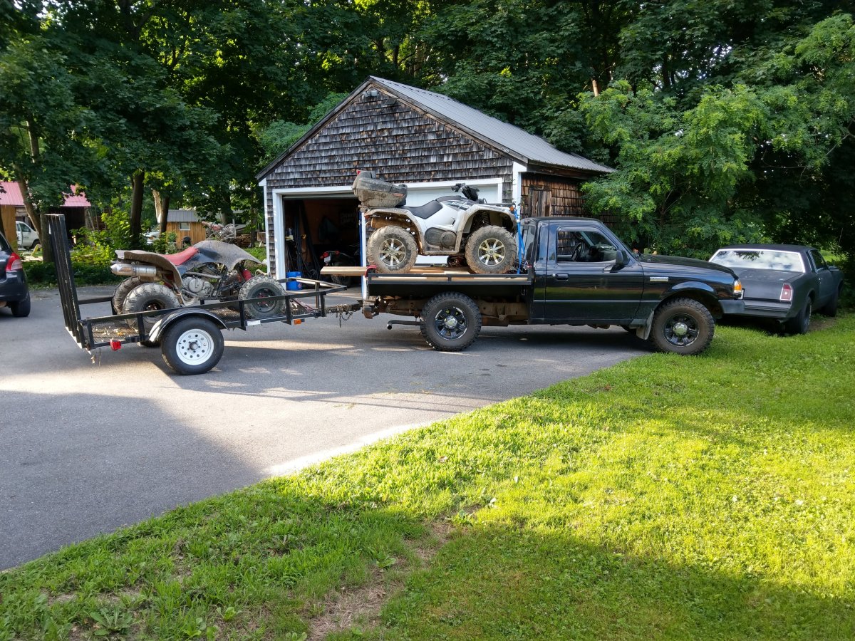

I had a 2010 just like yours before I got my 2021, and loved it.
I swapped the gears to 4.10s and added a Yukon Duragrip limited slip diff, put it on 30x9.5 mud terrains, and built a flat bed for it. Put bilstiens on it when the shocks that came in it blew out.
Lifting 2wds of that era is a potential pain in the ass. When I had the truck, none of the available lift spindles played well with the abs/trac/stability systems, you'd get a menagerie of dash lights on and I wouldn't of been able to get an inspection sticker.
Coil spacers work, but don't offer as much lift and affect ride quality. 1" spacers won't affect the ride quality THAT much.. but 2" definitely would.
(I have a pair of 1" spacers and camber bolts for sale if you want them lol)
Don't bother with dual exhausts, cold air intakes, chips, or even the k&n drop in filters.. at best they won't do anything for performance and at worst they'll award you with less performance. If your after form over function... go for it. It's your truck after all.

I don’t plan on doing any cosmetic mods. What’s the 2021 Ranger like? I like your 2010 one. I thought for like 2 minutes about getting wheels and tires that would fill in the panel gap a little and make it look sleeker, but I wouldn’t even know where to start with that. I just like that the truck offers a good platform for doing things considering how simple it is. Doesn’t look like there are a lot of macguffins to go wrong. My Jeep I traded was full of electric stuff that could go wrong in the future and be nearly impossible to replace without taking it to a dealership
I just rolled over 33k miles on the 21 and it's been flawless so far. It's taken me places my old 2wd couldn't even dream of AND let's me haul around 30+ year old GMs like it's nobody's business lol.
I love the truck. Wouldn't hesitate to purchase again.
