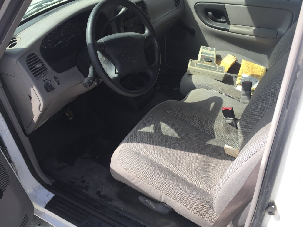

Here's the interior, a bit dusty from sitting, but overall in nice shape. Whoever ordered this truck spec'd it with no options (not that there were many on the Ranger EV's. Most of them were fleet trucks. They were only available as a single cab, short bed.

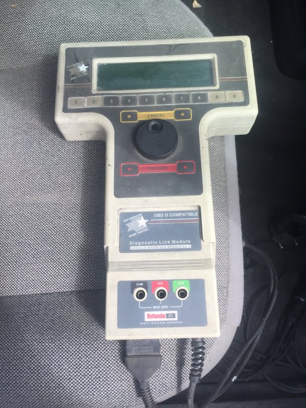

And this is a Ford "NGS" diagnostic scan tool that was included for those of you that haven't seen one.

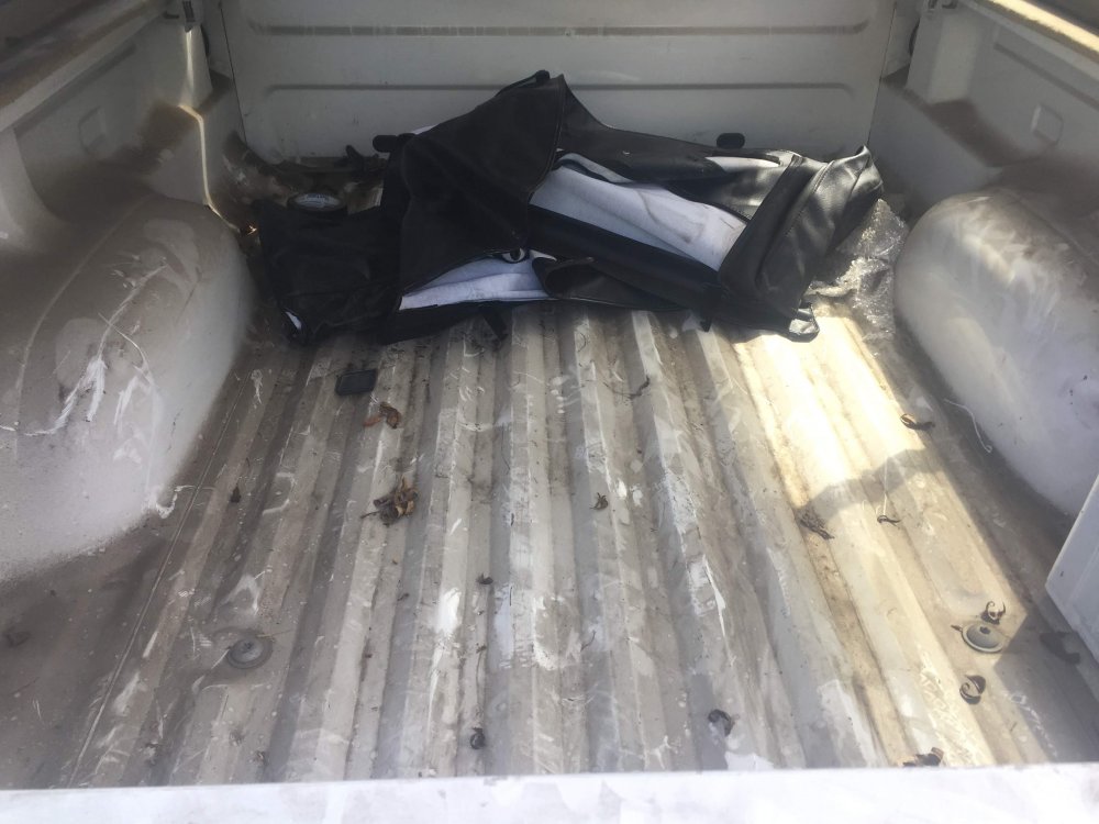

The bed, despite being kinda dusty looks pretty much unused.

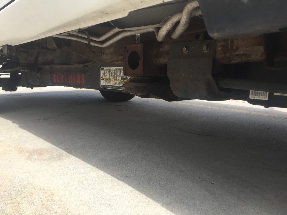

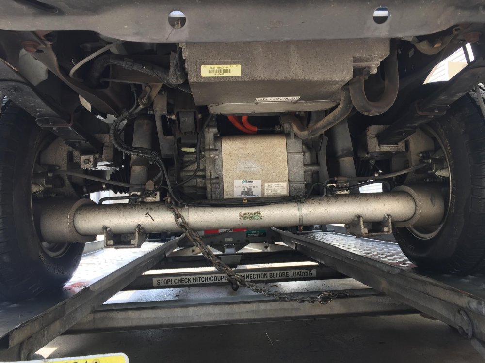

The battery pack runs almost the entire wheelbase of the truck between the frame rails. I'll try to get a picture of the whole underside when I can get the truck on a lift. Those coolant hard lines run to the back of the truck to cool the rear mounted traction motor, and it's inverter.

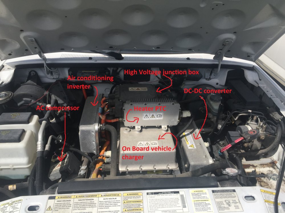

Under the hood. Everything that would normally be belt driven (AC & power steering) each has its own 3 phase AC motor and inverter. It does use the conventional hydraulic power steering, just with a motor to drive the pump, which is hidden underneath everything else under the hood. The DC-DC acts as the "alternator", which steps down the high voltage to power the 12v electronics. The heater has a resistive element in the heater core, no coolant used used for cabin heat. That means no waiting for your engine to warm up, hot air comes out almost instantly!

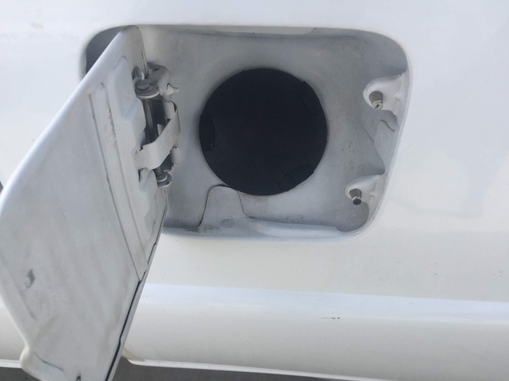

Nothing to see here.... They literally just blocked off the hole for the filler neck with a piece of plastic.

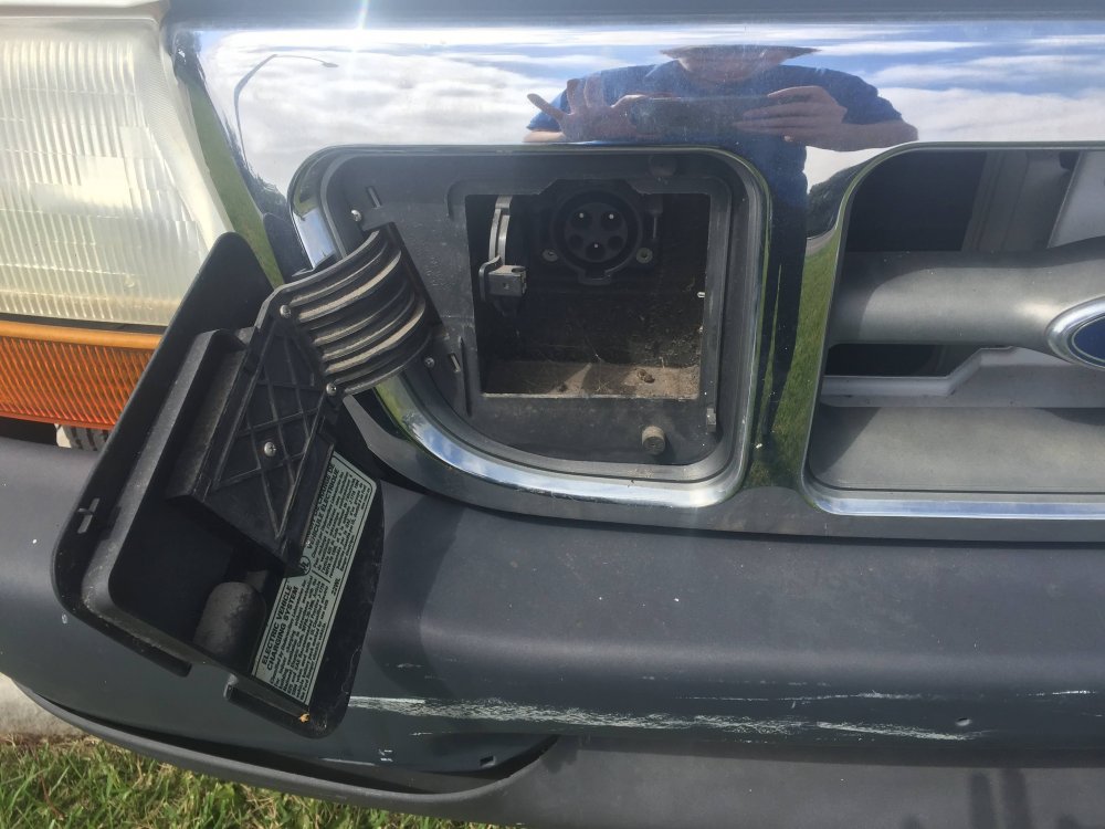

27834
Instead, you plug in at the front behind this flap in the grille! The plug on this has been updated to the current standard, originally it would've had a big rectangular "Avcon" connector.
27835
Is the radiator cooling the traction motor & inverter?
EDIT: I would think you'd need a significant reprogramming to charge the LiFePO4 batteries? I'm more familiar with stationary lead-acid, but if it tries to trickle charge or equalize it will kill them. Also, because of their very constant discharge voltage it will probably not have any idea how much charge is left in them.
Yes, the radiator is to cool the traction motor and inverter, as well as the DC-DC converter, onboard charger, and the inverters for the A/C compressor and power steering pump.
The Onboard charger will be/was bypassed with another onboard charger more suited for the LiFePO4 (or whichever other chemistry I use).
The “fuel” gauge will not be accurate unfortunately, so I will probably use an android based stereo so that I can run Torque on screen to monitor the pack via the CAN data from the battery management system.

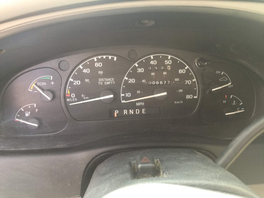

There is little giggle factor in that instrument cluster. Fuel Gauge, what does it do? Hot and Cold Temp, what is it reading? The ON/Off indicator dial? The distance to empty dial, now that's just funny right there. Had to come back and look. Great find.
Cool Truck. I thought FORD got all of them back. Guess NOT
If you look real close the fuel emblem actually has a plug on the end instead of a fuel nozzle, haha. It basically is just the state of charge meter. The temp gauge is for the coolant just like normal, but runs at a lower temperature, so the gauge is calibrated for lower temps. The rear mounted motor, and inverter are water cooled, as well as the onboard charger, DC-DC converter, AC compressor inverter, etc.

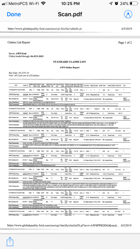

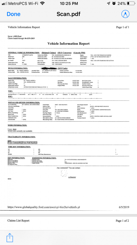

Nope! There were about 2-300 saved from the crusher thanks to efforts by both the original lessees, and groups like Plug In America. There’s a pretty active community of folks who take a lot of effort to keep these trucks on the road. At this site there’s all kinds info, like the original dealer/shop service manuals, sales documents, etc. fordrangerev.com. They even have access to the original build sheets, and dealer service history, here’s mine...
here
