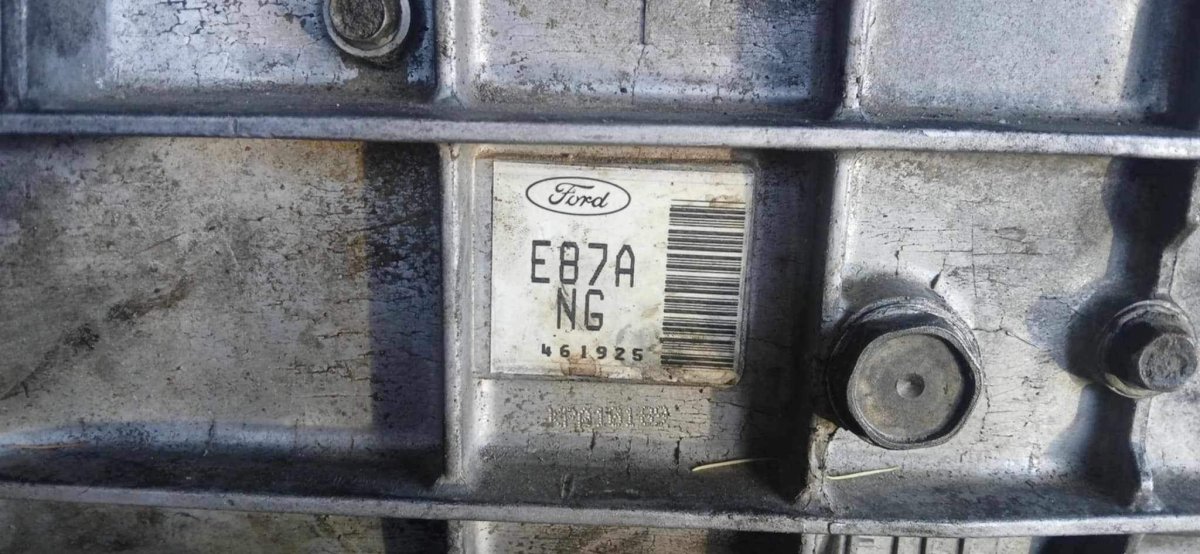

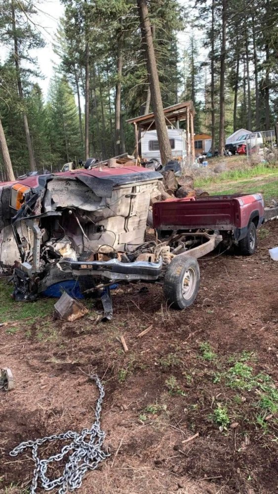

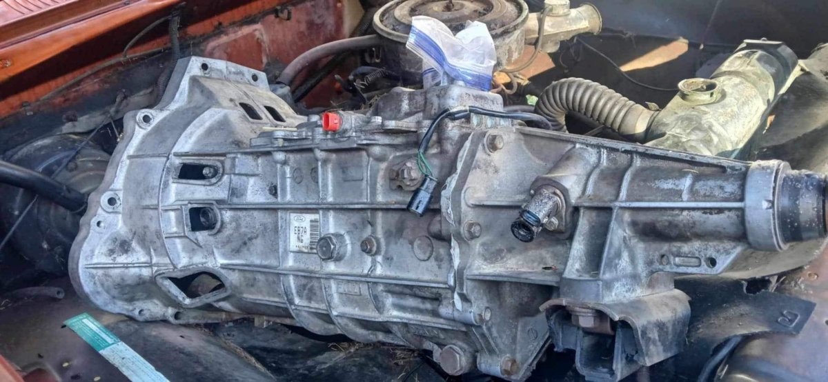

Thank you all for the replies. The adventure starts at O dark 30 tomorrow morning to go get the parts truck. I think it’s a Mazda M5OD because of the non removable bellhousing? Box and frame became a trailer (not included) but the cab, forward frame, transmission are all there and going to make sure to get the trans cross member and driveline.
