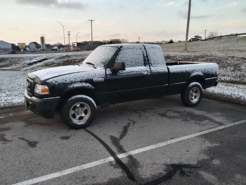

New guy, looking for helpb who would have guessed. I have a 2008 Ranger with 2wd, coil spring suspension. I have read this year sits slightly lower than others. Stock tires are 225/70/r15. I bought 4" lift spindles and 2" lift shackles. I want to purchase 16"x7" or 8" wheels and 265/75r16" tires. The height of tires would be from factory 27.4" to 31.6". Does anyone foresee problems, issues, or see this as good to go? I will also be trying to find an axle with l/s 4.10 gears to rebuild as mine are 3.55 and this would bring the ratio back almost dead on.

This is how she sits now. Almost pitiful if it wasn't such a peppy little pickup.
