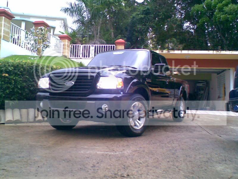

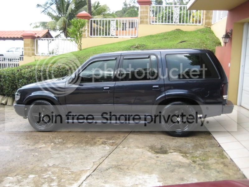

here are my trucks.

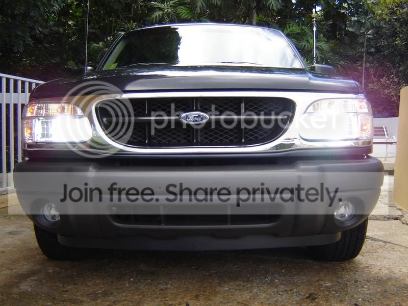

about the fogs, i bought a pair of RX330 projectors (headlights) and fabbed some brackets and put them in my fogs with 8k bulbs(ERROR)...
