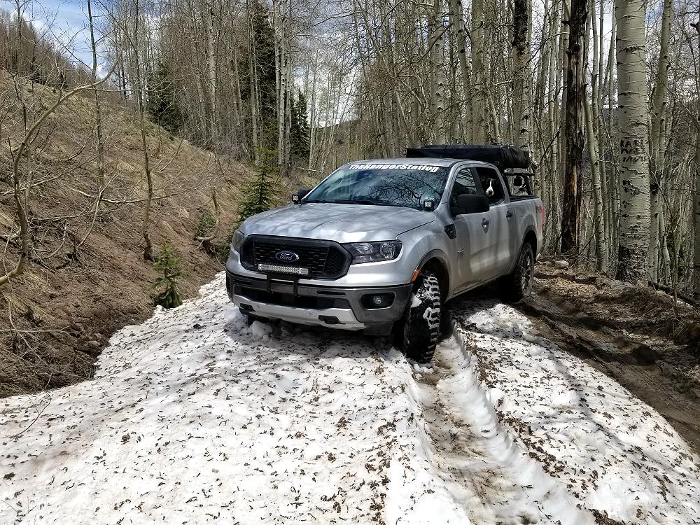

This was last year in Colorado. Going up the hill in 4WD. Open front diff. Left wheel under 4WD power digging through. Right wheel (not under 4wd power) getting to much resistance from the wet snow. Truck started sliding left and basically pivoting around the snow pushed up in front of the right front tire.
Perfect example of the stability problem illustrated. Three wheels at the limit of traction, and additional resistance from non-driven right front wheel imparts drag. It would likely have kept the back end in line with an open diff, because one of the back wheels would be 'tracking' in a rut from the front wheel..... but you'd have lost a third of the driven wheel traction.
Would have been an interesting test of the idea of backing up the hill to see if there would have been any difference. Were you able to keep going? What kind of tires did the truck have?
