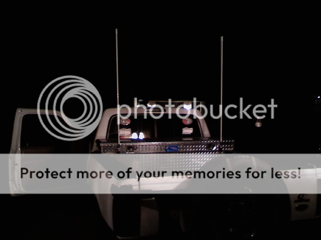

twin 4' fiberglass barjan's. they look pretty sick on the toolbox, i think. installation was kind of a pain in the ass in my driveway in the damn dark lol :icon_twisted:
i'm pleased with the outcome, though. lemme know what you think!
Have You checked the Standing Wave Ratio, or SWR?
It is a good Idea when installing any Cb Antenna to put a SWR meter in line and check the match of the antenna (s) for best results.

yeah, i'm trying to get a hold of someone with an SWR meter so i can tune the antennas right but no luck so far. without any tuning, though, they work pretty well. much better than the little magnetic 26 incher i got from walmart lmao
don't throw away that cheapo magnetic one. they work best when on the trails in a group. small and compact with plenty of range for that activity. and if they do catch a low-hanging branch, they just pop off without breaking.

dual antennas when properly installed and phased can be useful, but most people only get them to "tune up" to an aceptable SWR and have no concept of what phasing is...
And I'm not about to explain it in detail here, but it requires a tuned length of DISsimilar
impedience coax (typically 75ohm) to be inserted in line with ONE of the two antennae
But in essence while they look cool they rarely perform as well as
one properly installed and tuned antenna
when properly phased you can create a directional array that turns a circular propagation pattern wo one with distinct lobes....
Basically if those antennae are properly phased you'd throw a stronger signal forward and behind you...
Unfortunatly that might not be the direction of the person you are attempting to talk to. Roads are rarely straight enough for long enough to matter, nor do CBs propagate far enough under normal predictable circumstances to matter.
