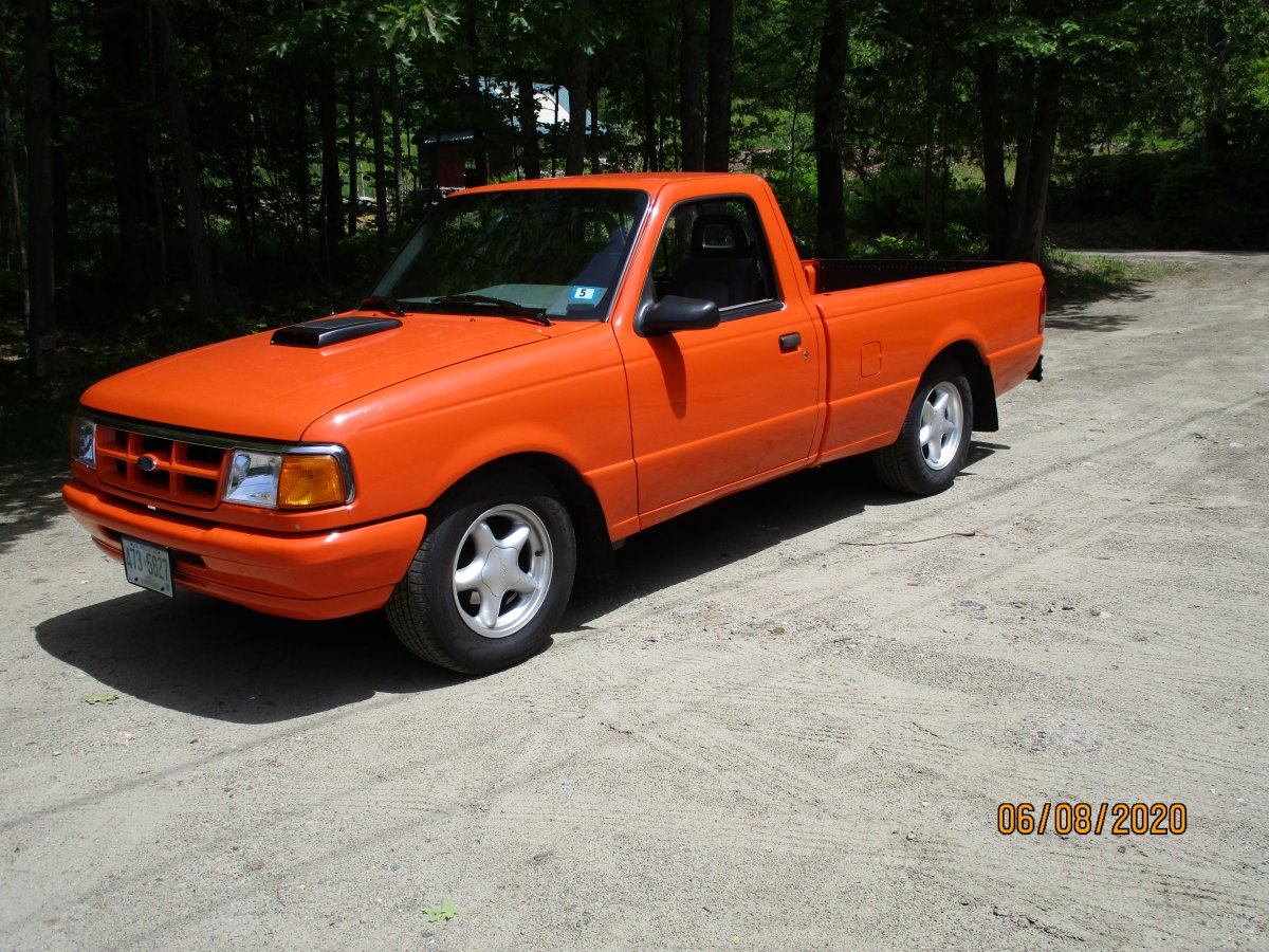

This is my 93 Regular cab, lowered with 94-5 Mustang 16" wheels and 235/65r16 tires. You'll need real low profile 17's if you lower it much. You probably know that 93 to 97 are the same series. I bought the wheels used because I wanted something stock looking that would make cleaning easier then the Weld Draglites on my Mustang. Be careful about backspacing, I had to fabricate some steering stops to keep my wheels from grinding against the lower shock mounts. The truck was in a car trailer when I first looked at it and I didn't realize it was lowered until we pulled it out. It has dropped I Beams and the rear end is mounted above the springs like an Explorer or a passenger car. If you lower it much without changing the I Beams it will be difficult/impossible to set the camber properly.

Ha, I saw those dreambeams, kinda costly but sounds like those are the way to go. That and flipping sumthin in the rear. Current tires are dry rotted pretty bad, so I gotta make a decision soon. Honestly prolly just replace the tires for now, and revisit lowering down the road. Is your hoodscoop functional? That's the other thing I wanna do. Recently swapped out my SVOs engine, and like to try rebuilding it, then dropping into the truck. Was reading a little about that last night. I was able to pull off doing it in the SVO but everything was generally a direct swap. I've had to do a little fabricating but I can't weld. This truck has working AC (unlike my old hardbody) and I'm damn sure gonna keep it. Sounds like keeping AC can be tricky when adding a turbo. Hope I can find someone on the forum to help me thru that part. Thanks for the info, your truck looks great, I like that red
