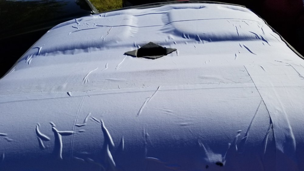

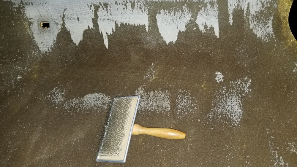

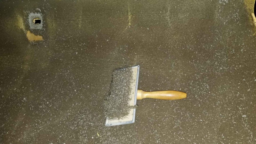

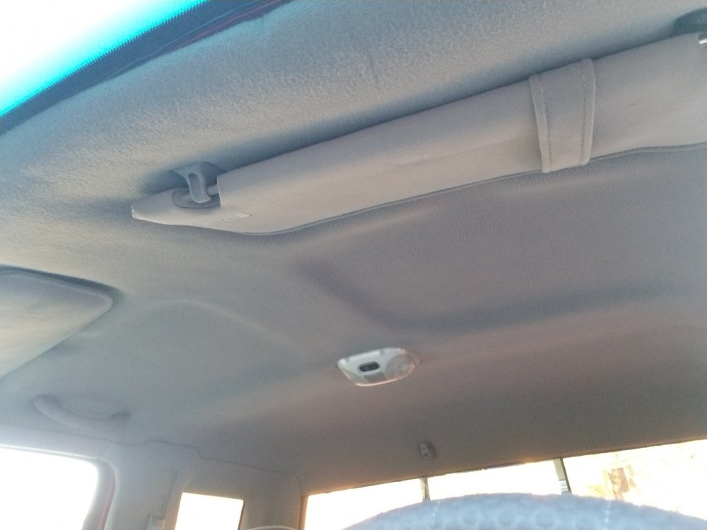

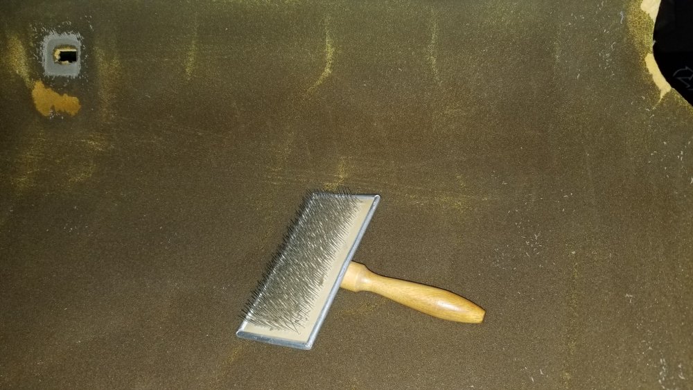

I took the bull by the horns and took out the shredded headliner over the weekend. I used the dog's slicker brush and a shop vac to clean all the old fabric and any loose foam off the fiberglass board. I bought sturdy cotton cloth and foam-backed headline fabric from Joann's. I glued the cotton to the back side of the fiberboard to help make it more rigid and hold everything together where it was trying to tear. Then I sprayed and glued the headliner to the visible side. I know I stretched it too much in a spot or two, but overall it looks awesome compared to before (I forgot to get a before pick. Trust me, it was shredded from the Texas heat since 1996).
I also discovered I could fix my dome light buy putting a stiff, but slightly flexible stick between the two map light sections, over the circuit board. The stick ends up hidden behind the bulbs, but it holds everything up. (Yes I put superglue on all the plastic spots that are supposed to be connected, but the stick holds everything in place, so no need to wait for the glue to dry).
