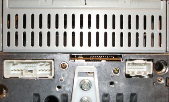

Would the factory in dash 6cd/radio from an 04 mazda tribute fit and work in my 1997 ranger? Thanks for any help guys, I am lost when it comes to electronics. :beer:
sure... is it plug n play? idk lol. it'll work if you wire it in make it mount right.
are both double din or single din size? what's the plugs look like on them?
Both are double din, not sure about the plug though. I wanted to get some opinions on whether it will work before I bought the mazda one. I guess I could find some type of adapter for the wiring? What about overall size, anyone know if they would be the same?
I found this pic on google and the plugs for the radio harness are way different. It would phyisically fit but you would need the tribute factory harness and plug that plugs into the radio and look up which wires are which on the tribute wires. Then you would have to wire it to the ranger aftermarket wiring harness. sounds like more work than its worth.
Thanks! I think if it will physically fit in the dash it might be worth trying. I can get the new radio for 20 bucks, but I cant get the tributes factory harness. Is there an anti theft to worry about with hooking it up?

not sure if this helps with the anti theft but it tells you which wires are which
Loudranger, I appreciate it greatly! Repped!
