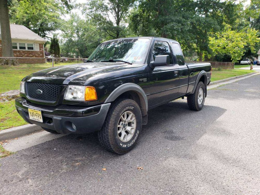

I’m not sure what kind of tires and rims I would like and I would like some help or suggestions. I want 17 inch rims in order to put the 5 inch rough country lift but I can’t find anything. I’m coming to here for some help thank you

So I drive to and home from school then work. Then on the weekends I like to off-road. I would like 17 inch rims. I’m doing a lift for off-roading. I have 16’s on now but In order to lift I need 17s. I was looking at these rims.
