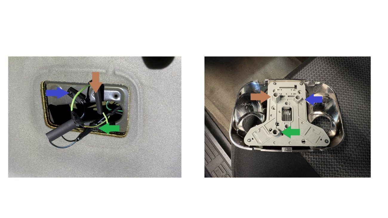

Ok, so I needed to go to pull-a-part to get the dome light wire termination plastic pieces (mine actually disintegrated when I was removing the head liner). So, I think I wired them to the correct wires with the one's from pull-a-part when I spliced in the connectors, wire colors seem to match up. I have run a test light on them and the one that is BLUE (with blue arrow) is powered on when the door is open or you turn the dome light on. The GREEN (with the green arrow) has contant power. I put the BROWN arrow to indicate where the dome light housing gets grounded with a ground screw. So the problem is I don't want to over tighten the screws because of my fear they will break and come apart like my previous connectors. But there isn't any real consistancy as to how the switch works left, right or middle. I mean after hooking the housing up with the switch all the way to the driver's side the left map light will come on when I open the door, but if I close with a little normal force sometimes the dome light will come on and or maybe even the map light. It is just weird, looking for some advice/help... Thanks

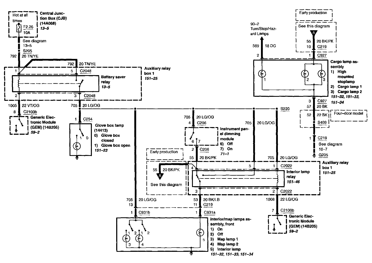

I am assuming you are working on a 2003 4 cyl ranger. Here is the diagram for that. I see a lightgree/orange and a black/lightblue wire.
Looks like lightgreen/orange is the hot all the time and the black/lightblue is for the dome light.
Looks like lightgreen/orange is the hot all the time and the black/lightblue is for the dome light.View attachment 138221
Ok, what I said previously was incorrect as far as the constant power wire. I should have said the green one. What you have said is correct. If I just run the screws in for the ground (BROWN ARROW) and the blue wire, the dome light works as you would expect (but it only works to the left or right map light relative to where the switch is set to (it doesn't work on the center dome light). Hopefully that makes sense. So, it seems as though when I run the screw in for the constant power (GREEN ARROW) everything lights up, and it doesn't shut off when the doors are closed, or the dimmer switch is set below the full-on position. What is the problem. I am thinking it has to be with the housing...
You can see from the diagram above, the switches on the light unit should not affect the domelight whatsoever. I believe you are correct, the domelight itself is still not working right. I would take it down, put it on the bench, get a small battery charger, and power it with that on the bench and with a meter, try to figure out what is going on.

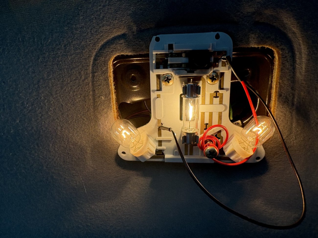

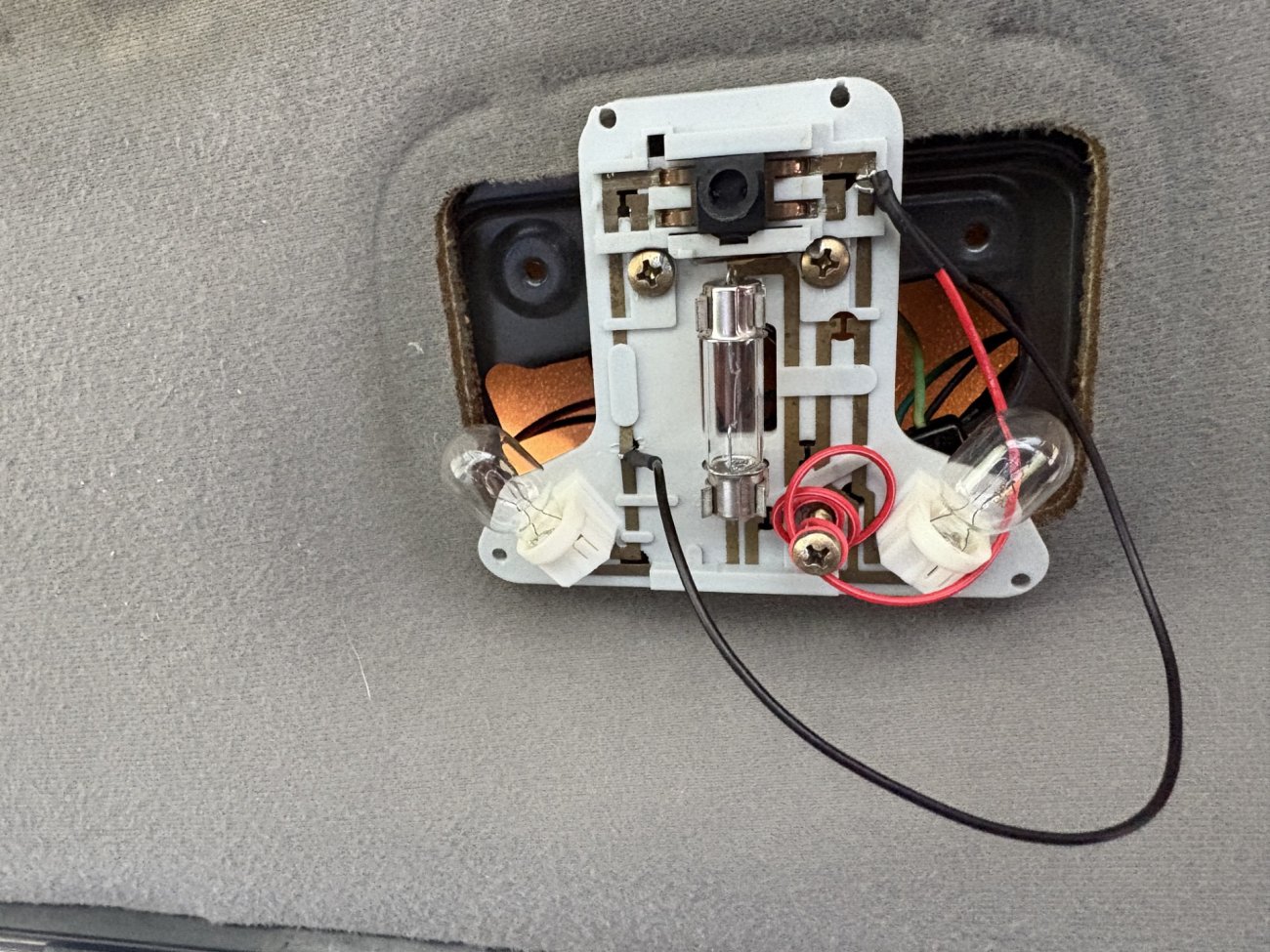

I am pretty sure this isn't what the FORD people had in mind, but this seems to work. Please keep the jokes to a minimum... Everything seems to be working at least how I would like for it to. If the doors are open and the switch is set to the drives side all the lights come on. If I turn on the dome light with the panel dimmer switch, all the lights come on. If I have the switch set to the center location all of the lights stay off...I am sure there is probably a better way to do this but the electrical stuff is not something that I excel at. I want to thank everyone for the feedback and help. I am pretty sure that I will disconnect the constant power wire and just use the just the door/dome light power for now...
