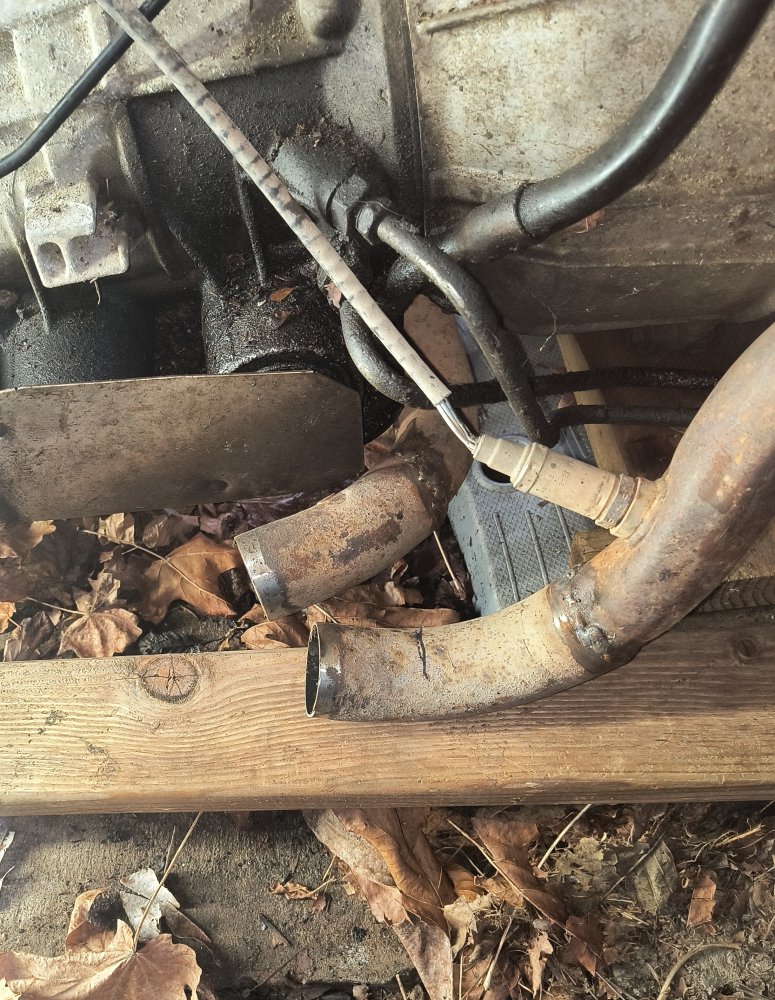

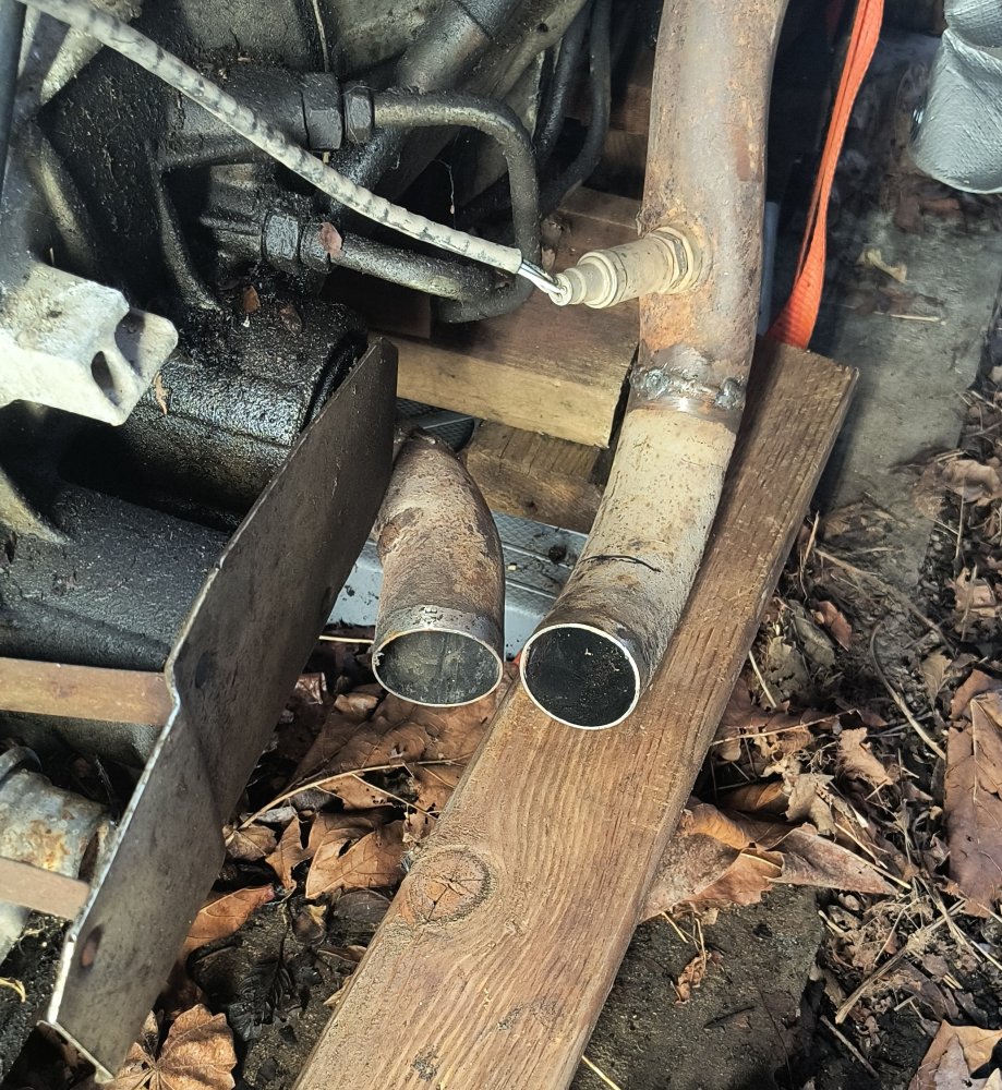

Stock manifold exhaust tubing (89-94 style) has been separated and is hanging loose, ready for cats.

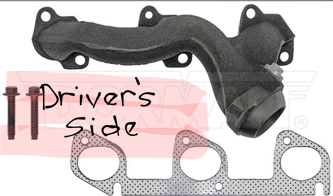

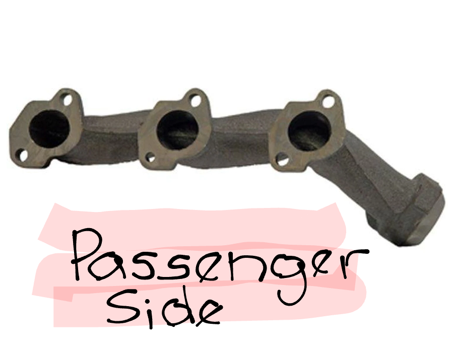

I am not a great welder but you can use a set of these, they are for the 98+ OHV 4.0l and they will bolt up like money.
Dorman PART#
674-379, drivery
674-378, passenger's

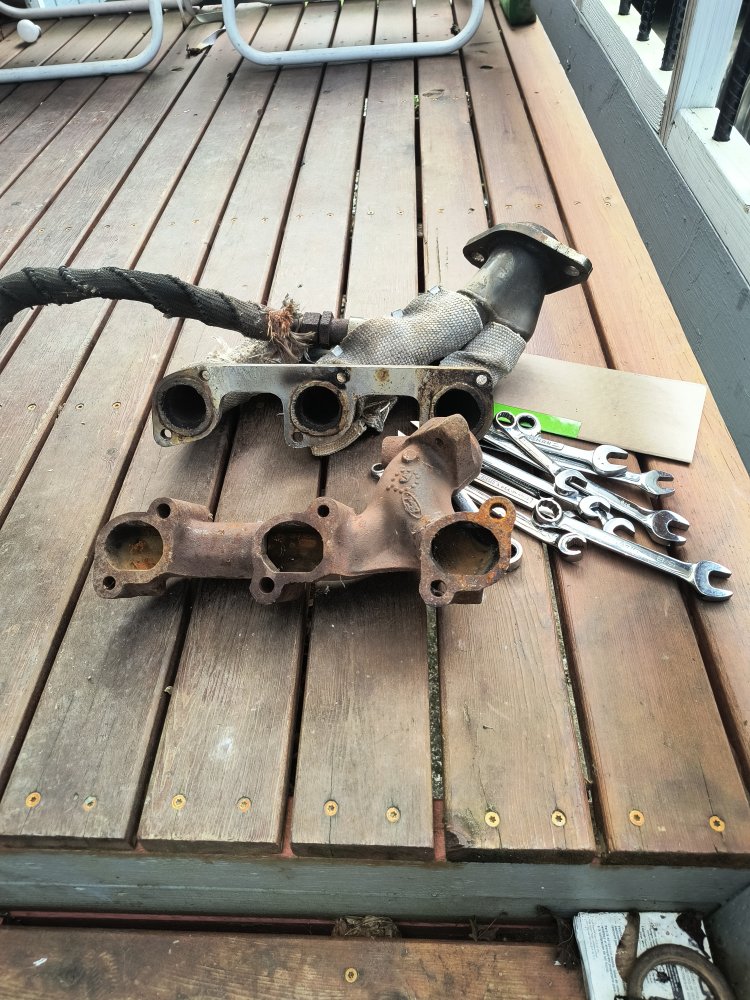

This pic shows flange and tubing size relationship of stock driver's side exhaust manifold compared to driver's side JBA 2.9l header (pictured stock manifold is actually 94 spec 4.0, but it is the same as 2.9 except for port size and shape)
Dorman PART#
674-379, drivery
So I should take these and continue off of them to make the dual 2”?
Those are stock manifolds, they do offer an improved design over what was offered with the 2.9l but ido not know that they will outflow the stock 2.9l exhaust manifold... I'm ordered a set last week and am going to compare the results.

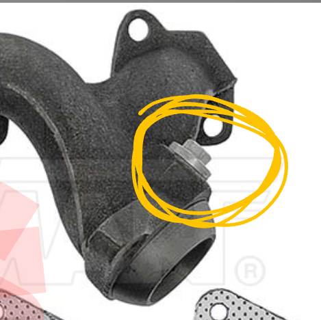

If you do decide to use those 98+ OHV 4.0l Dorman exhaust manifolds, the driver's side is set up for EGR, you will need to plug that for 89, 2.9l.
Okay I think I’ll go with the manifolds and plug the egr thanks for all the help
