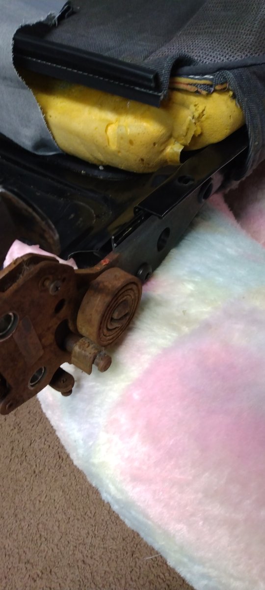

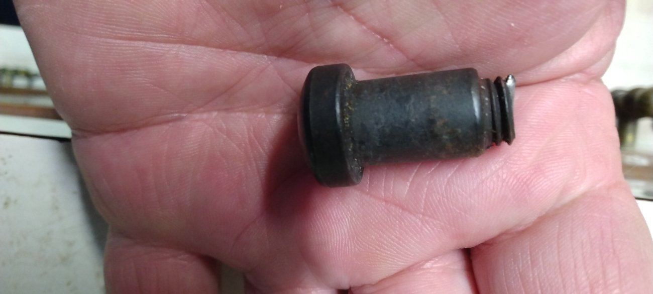

I took my Driver seat appart because something was not right. As you can see, one Bolt was broken. I had to drill the stuck piece out.
Yesterday I went to Napa to get a new bolt but they can't find nothing. That Bolt has a bigger diameter on the part with no tread compared to the treaded part. Does anyone knows where to buy Bolts like that ?

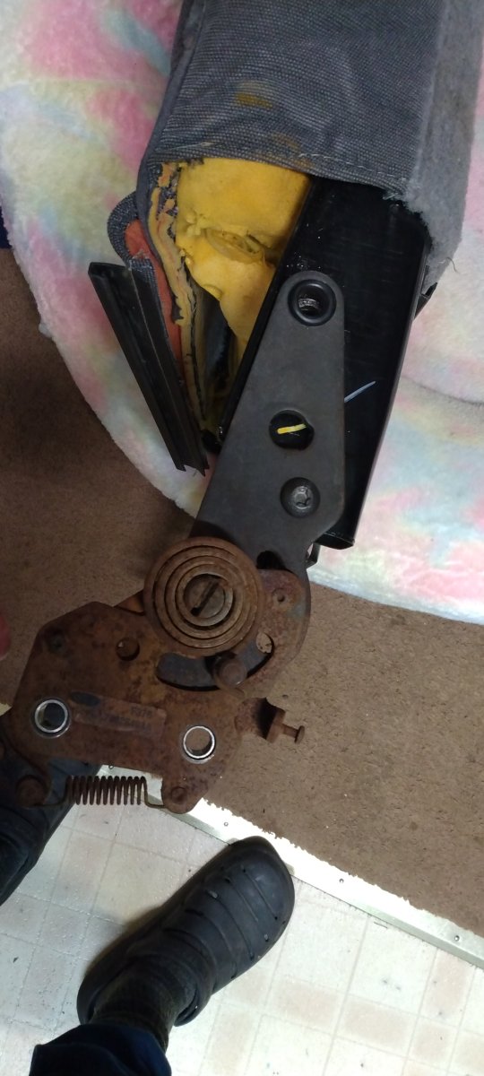

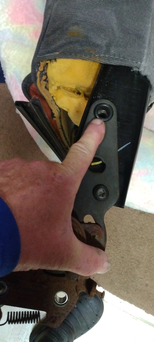

Is there a special name for these typ of Bolts? The Bolt goes where I point to the plastic gromet/ bushing.
I also have a Lottery question. How the heck can that Bolt break like that while it is installed ??????????????????????? There is no other damage on the frame. Just the broken bolt.

shoulder bolt.
specific to the application, I would get one from a salvage yard.
for a temporary fix use a regular grade 8, or metric 10.9, and put a bushing over it.
it's probably been in the process of breaking for the last 20 years due to over tightening at installation..
I just realized, I don't know if the seat is a real Ranger seat. But the seat was bolted to the Ranger Rails.
You can order shouldder bolts online. Should be able to find some pretty close to exact. You need the diameter of the threads and the diameter and length of the shoulder. If the shoulder part us a little bit too long, just add washers.

As mentioned, they are shoulder bolts. A bolt with a bushing could work if you can find the right size.
The place to get shoulder bolts is McMaster-Carr
I went the easy route. norml 10mm Bolt and a plastic Bushing. ...........Thank's for all the advise and jokes.
