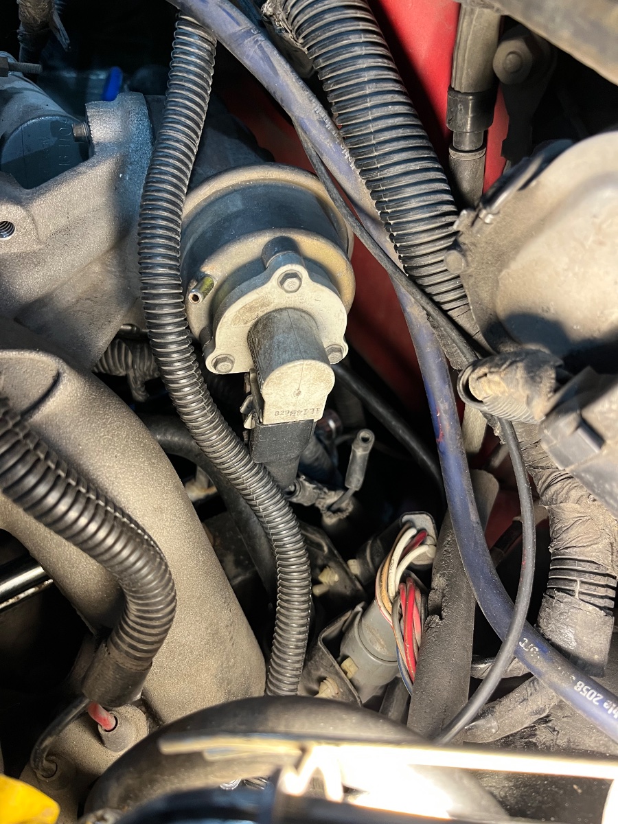

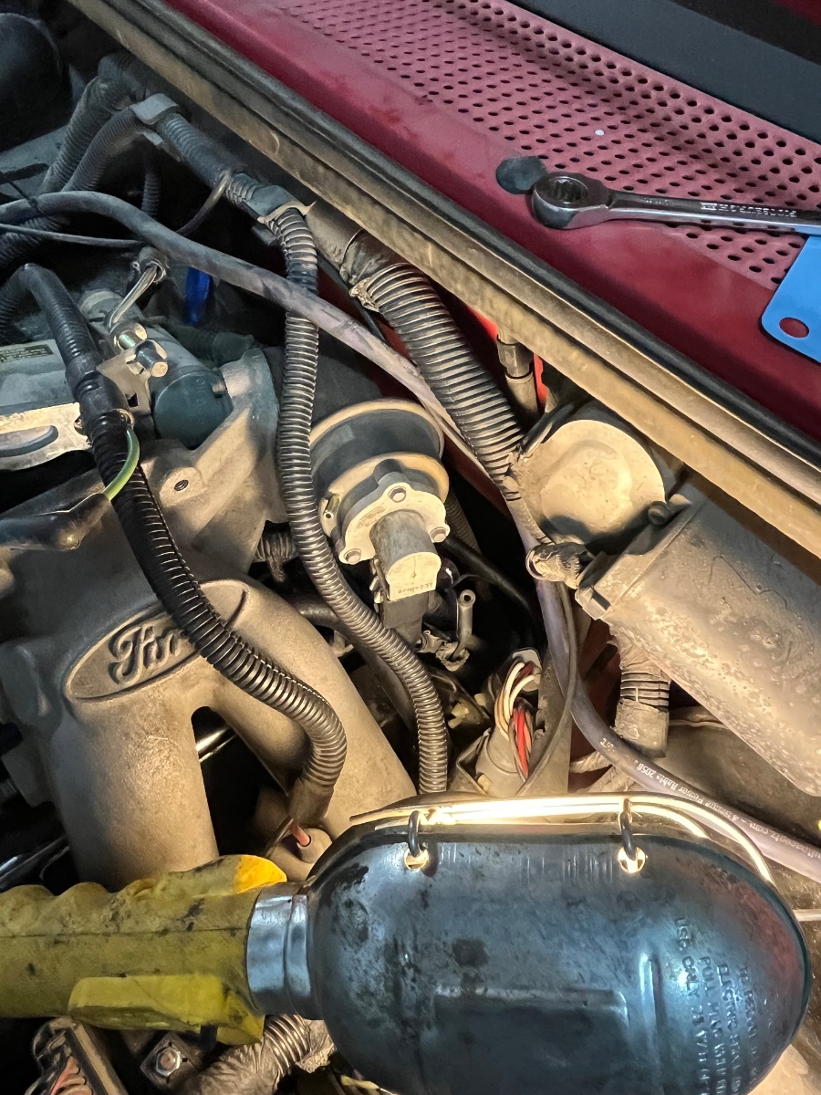

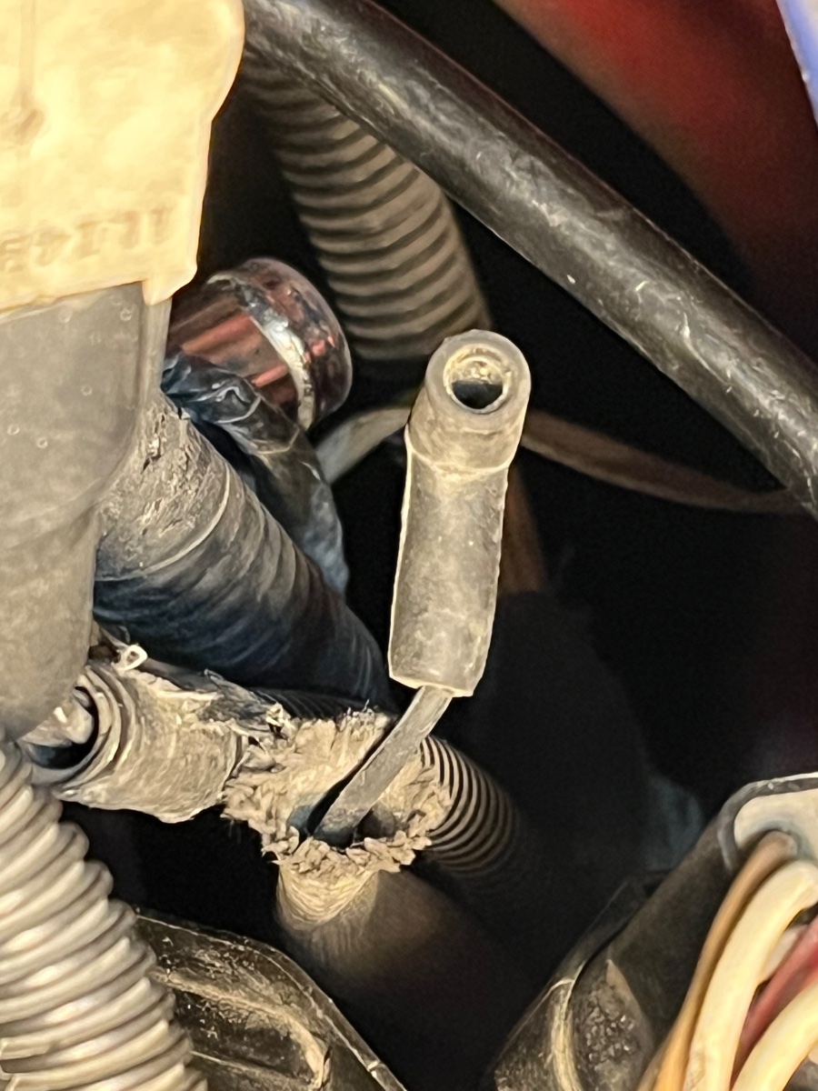

Cannot find where it connects. Black with green stripe. Thanks! Found it. Oil pressure sensor I believe.

You have a "low oil level" light. That runs out to what looks like a float, on a white/pink wire.
You should have a oil pressure gauge, it runs out on a white/red. Ford has used that color for many years. The coolant gauge uses black/lightblue wire. These wire colors will fade over time, make sure it's not the coolant sensor.
Sorry to be so dense but the sensor at back of head I am thinking is coolant temp and I have white/red and the black /green or blue connected below that on the block which I am thinking is oil pressure. The white/red won't reach below the head. When I started it the oil pressure gauge never moved but temp did eventually. Thought I had them crossed but the one is too short to be crossed. Put a new head on this 2.3 for a friend so just trying to get it done. Not familiar with this thing. Thanks for the help.
The coolant temp is just over the oil filter sorta, and in the block, the oil pressure is in the head just behind the intake manifold.
