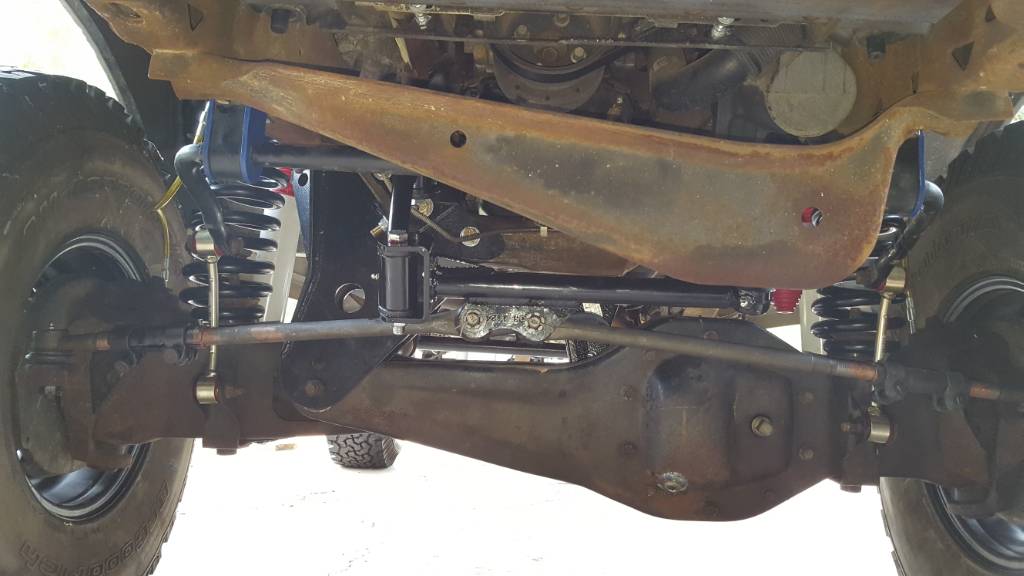

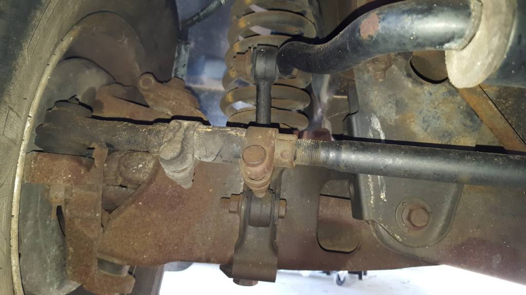

Pics would be helpful.
Do you know what kind of lift kit was installed? Some of the better lift kits replace the axle beam pivot brackets, at least for 4"" and 6" kits. Pictures of your axle beam pivot brackets and radius arms may give us a clue about what you have to deal with. A picture showing how much the camber is off may help also. If all your brackets are OEM, then it's probably an adjustment issue as mentioned above.

The radius arms look like they have an added drop down bracket on the existing brackets.
Not sure what the axle bean brackets are supposed to look like stock so I'm not sure if they are extended or not ?
Not s great picture, but you can see the stock axle beam pivot bracket for the driver side beam ( bracket located on passenger side of truck) in the right side of the photo below. If your radius arms brackets have been lowered, then the axle beam pivot brackets were probably lowered or replaced also. In the second photo, you can see a Skyjacker lift bracket for the same side.

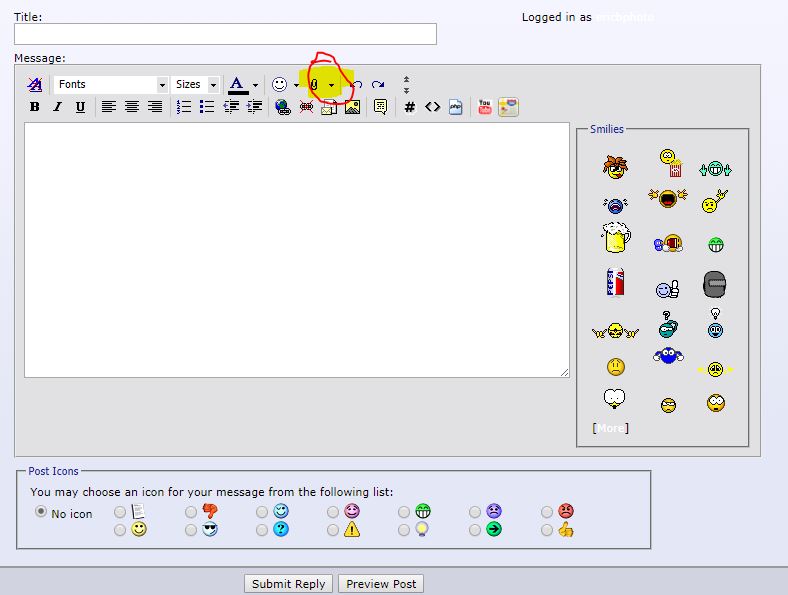

To attach photos, use the "manage attachments " button at the top of the reply editing box. That will allow you to upload pictures from your computer. There is a file size limit. I don't remember what the limit is.

Thank you for the pictures !!!
The axle bracket on my truck does not look like the stock one. It looks longer, It measures roughly 14-3/4" from top to rounded bottom (vertical measurement)
Where is the "reply editing box" ?
I was talking about this. In the picture below, I circled and highlighted the "manage attachments" button.

I do not have that on my "post reply" screen. I have everything else but the paperclip thing.
I assume that I have to turn that on somehow?
Might be a "newbie" thing. Some forums make new members wait a short period before they can post pictures.
