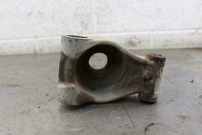

The housing is made of aluminum and looks like this...

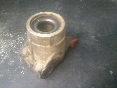

Back side.
Front side.
1- Do you think its safe to hook a jaw puller to the housing and try to press the CV out of the housing?
2- Can i use heat? (map gas)
3- Would i be safer to use a block of wood on the cv end and a sledge hammer first?
Any ideas is apperciated.
I'd be tempted to stick it in the freezer overnight, then CAREFULLY heat the housing and give the bearing a few taps with a wood block and hammer. And maybe hose it good with PB Blaster or similar, beforehand.
I'd be concerned that a jaw puller would stress too small of an area on the housing and crack it.
Good luck!
1. Yes. Put some tension on it with the puller, then give the end of the puller a whack with a hammer. That will usually break them free.
2. Last resort... don't go too crazy with the heat.
3. Yes. That's what I would try first.
It looks like a ball joint press would push it right out... after some PB and a bit of heat.
I’d get a piece of brass or something soft. That’s the size of the other race. And tap it from the back side.
Perhaps that picture wasnt the best thing, thats not mine just one i found on ebay lol.
The CV shaft end is actually stuck in the carrier, hung up on the bearing. Getting the bearing out shouldnt be to rough, i hope. But in order to get the bearing out i gotta get the CV shaft out of the bearing lol.
I never heat aluminum that I don't plan to replace. Not with fire anyway, maybe with a heat gun.
1] in the freezer and then heat gun on the aluminum and some gentle tapping.
2] As above but pound the shaft against something solid. You are doing the same as setting an axe head or hammer head onto a shaft, but backwards. Let the weight of the housing work with gravity as you pound the shaft down. I don't know if the housing and shaft are going to be oriented to let this work.
