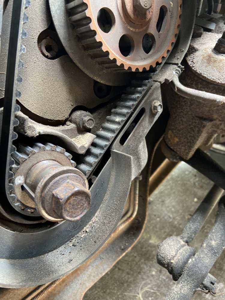

As an update, The truck was out of time - surprised it ran at all! It either jumped time, or the last person that was in there did it to an incorrect marker. I replaced the belt, water pump, and a few other things on my way in there & she runs like a dream, is pulling the correct vacuum, and doesn't sound like a tractor anymore.
how far out she was - cam was at the timing mark ( for those who don't know, the white dot should be at that notch)

Most times the keyway in the crankshaft is at 12:00 when the engine is at #1 TDC. The cam sprocket triangle should be at the mark on the engine, a casting rib or a pointer depending, at about the 4:00 o'clock, and the aux should be 'somewhere', as in some don't matter and some do.
Sure looks as if the crankshaft sprocket 'dot' is not aligned with the keyway in the crankshaft. What does that mean? I dunno as I go by TDC and not the dot.
