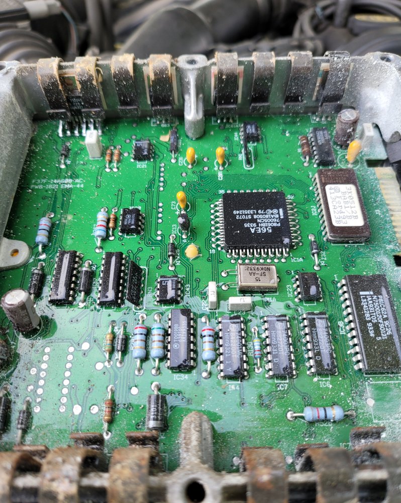

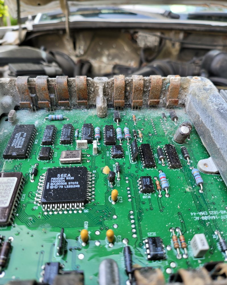

Pulled appart the ecm and this is what I found nothing burnt but there is corrosion on the inside it looks like can I clean it up and it be ok or should I look for a new one?

Doesn't look that bad, the "spots" are from the sealant Ford sprays on after assembly its like a resin
Did you pull up on the two capacitors to make sure both wires on each is still connected
You can use isopropyl alcohol, 99% is best, to clean electronics, its a solvent but also doesn't leave a residue behind that can short out connections
The J3 connector is in the middle left of 1st picture, make sure its cleaned up, no residue on contacts or traces
