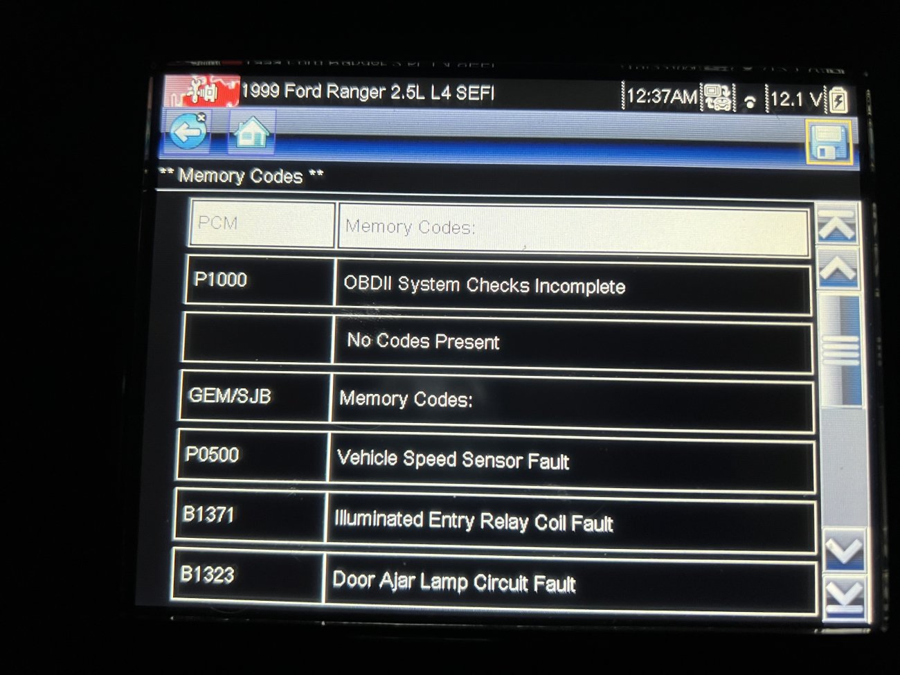

So my buddy and i scanned the truck. It has no CEL or anything. The only code that came up that was drivability related was a vehicle speed sensor fault.
We drove the truck around and looked at the live data and it all seemed fine, even the vehicle speed seemed accurate to what the cluster was reading.
I wonder of the trucks uses vehicle speed to help determine fuel? That would make complete sense. Its just odd that theres no CEL and the speedo still works, because typically when a speed sensor fails the CEL is on and the speedo stops working.

I just did a quick look and P0500 seems to usually be ABS sensor related not necessarily the same sensor that is used for the speedometer.
