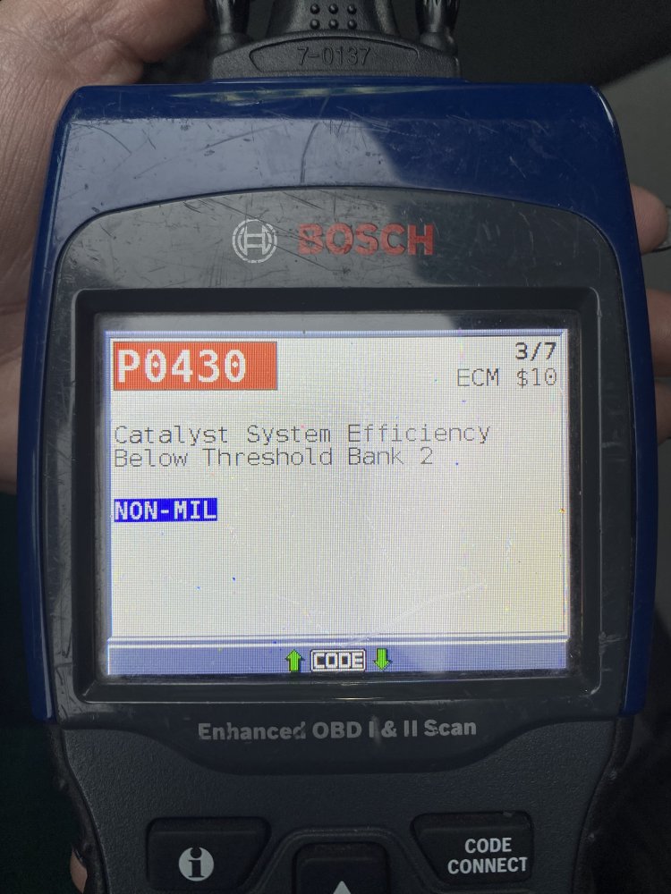

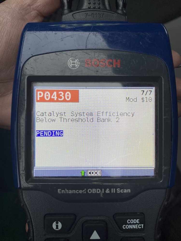

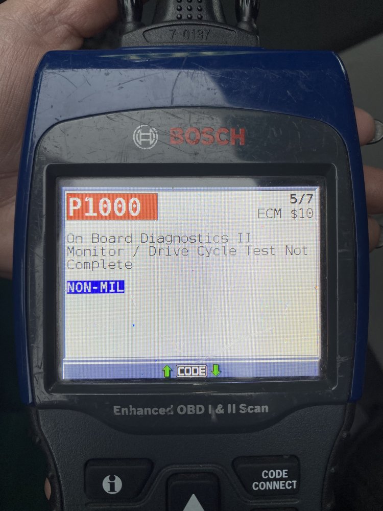

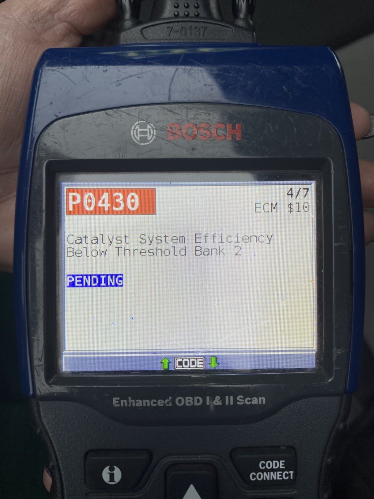

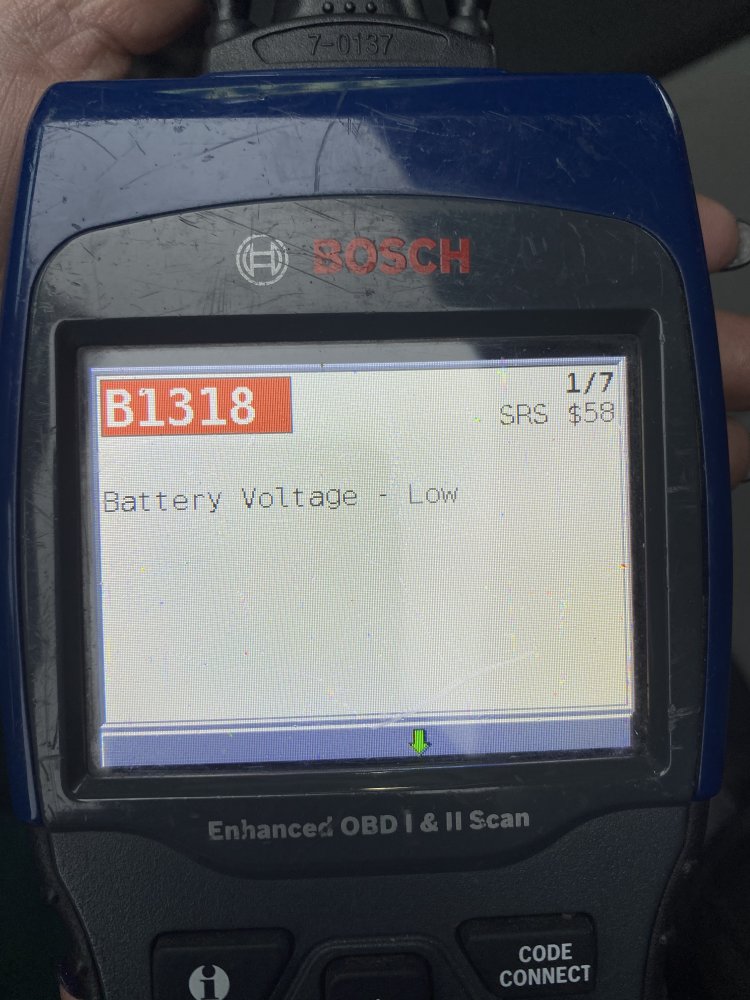

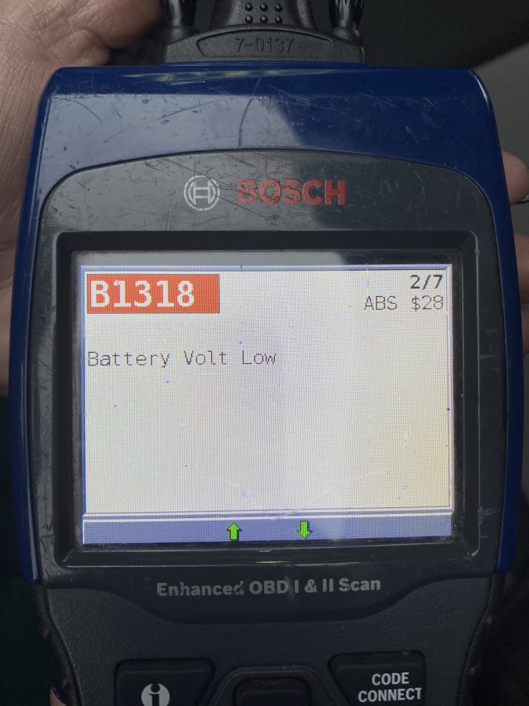

My check engine light came on today and I got the codes read. Still haven’t tested fuel pressure. Any

Well battery voltage Low is pretty self explanatory
Do you have a DUAL exhaust?
If not then there is no Bank 2 cat converters
Have a look underneath cab on passenger side and under bed, if you see TWO separate exhaust pipes going to the back then you do have a DUAL exhaust
If there is just one pipe then you don't
And yes, OBD readers will cause codes where no code is possible
P1000 just means battery power to computer was cut at some point in the last week or so
Check your battery voltage engine off and engine running
Engine off, 12.3v to 12.8volt
Engine running, 13.5v to 14.8volt
Just single exhaust. That’s weird about the battery. It’s not even a year old.
The code means it drop below 9volts at some point usually when starter motor is active, should only drop to 10volts on start up
Did you ever crank it over and over again since last time codes were cleared?
Did you ever disconnect battery with Key ON?
