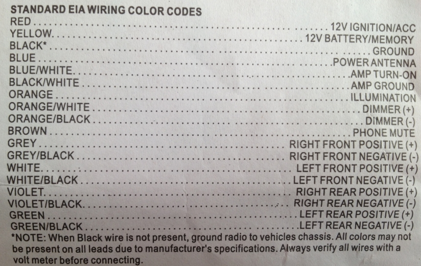

Hello:
I am trying to connect a Pioneer Radio to my 1998 Ford Ranger.
I just purchased the Metra 70-1771 harness and it did not come with the color code instructions. The OEM Package has the wire color code instructions printed on it and this came in a generic bubble wrap envelope (Not the OEM package). That is OK. The package is not the issue. The issue is that no instruction sheet was inside of the bubble envelope.
I NEED THIS WIRE COLOR CODE INSTRUCTION SHEET :-(
Does anyone here have the Wire Color Code Instruction Sheet for the Metra 70-1771 Harness.
Can someone email me a photo copy of this instruction sheet please ?
Just Private Message me please, and I can send you my email address.
Thank you guys and gals.
Gary

The colors on the Pioneer pigtail match the colors on the Metra Harness Adapter. Several wires were not used from the Metra harness including 2 Orange Wires and a Black Wire with a White Stripe (not sure what those wires are for).

The two orange wires are:
ORANGE = ILLUMINATION
ORANGE/WHITE = DIMMER
The BLACK/WHITE one = AMP GROUND
Wires
Found this for my 2010 ranger:
  • Need Color Code Instruction Sheet for Wire Harness - Metra 70-1771
