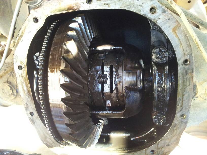

Yes it's been ordered. I'll post up up pics when we install it. Looks like powertrax just started making it recently. I may be one of the first guys to get one.

We got the locker in yesterday. Real simple install with good directions. The original clutch discs were completely gone nothing was left. I haven't driven it yet, still waiting for the rtv to dry.
